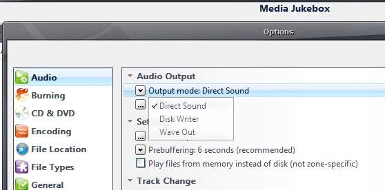

WASAPI, WASAPI - Event Style, ASIO, Kernel Streaming, Direct Sound, Wave Out, and Disk Writer are all supported natively with Media Center.  Media Jukebox only has Directsound, Waveout, and Disk Writer.

It does appear that they have removed ASIO and WASAPI support from MediaJukebox.  I have JRMC 15 installed on this laptop and it sees the ASIO driver for my USB Mobile-Pre device just fine. Out of curiosity I downloaded MediaJukebox 14 and installed it and it does not list ASIO or WASAPI as an output choice.

MediaJukebox no longer supports ASIO so ASIO4ALL is useless for this program.
