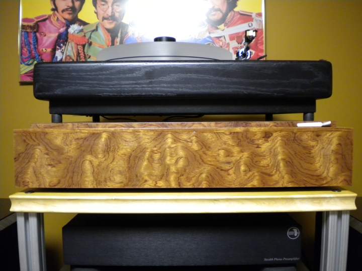

Paul here's my sandbox made for me by a good friend. It's made out of MDF and covered with african Rosewood veneer
beautiful wood.  I have some cherry with similar grain patterns. I purchased it to make AR plinths. It sat in the garage for a year and twisted.........Now I have some very pretty flower boxes.  :duh:
