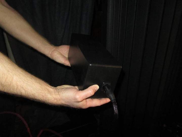

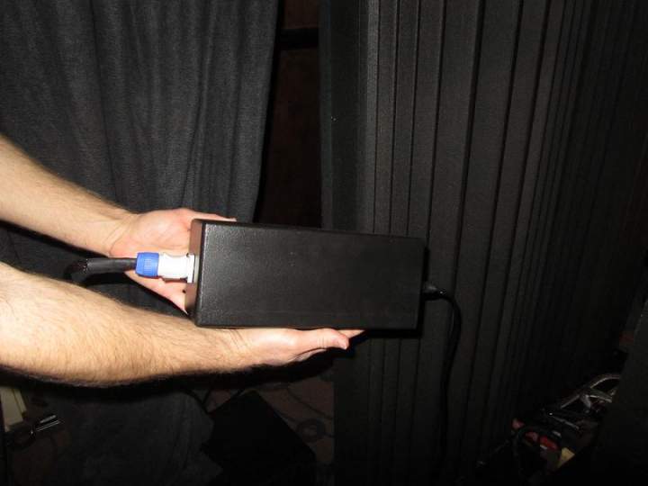

With Danny's help here are two pictures of the BatteryBUSS prototype at Axpona 2011.

OK.  So the battery isn't in the box...the box is the "Buss" part.  Got it.
Sorry, man.  I thought that i made myself clear about the BatteryBUSS being a separate bit of gear from the battery.  My bad.
Another thing to note is that this basic unit can be used for ANY 12V piece of battery powered gear to increase headroom and dynamics in the target component.  Dodd battery power owners take note:  the BatteryBUSS will provide increased dynamic contrast, soundstage and flesh out the harmonic texture just a bit more.  The output impedance of the battery is a wee bit too high to deal with instantaneous current demands.  With the tube gear it is not as big of a difference as it is with SS gear, but it is there to be sure.
