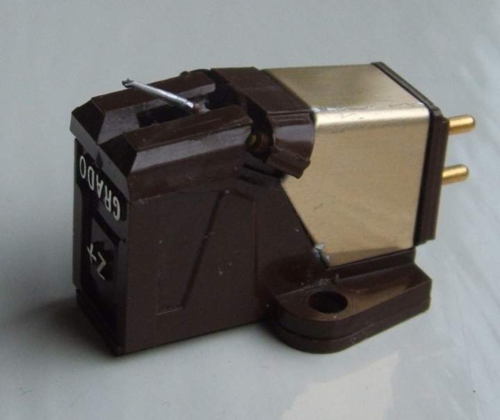

This post is prompted by a bit of tic-tac with Wayner regarding a little cantilever mishap - Here  :duh:
I'm sure this sort of thing has happened to most of us, probably more than once.  :oops:

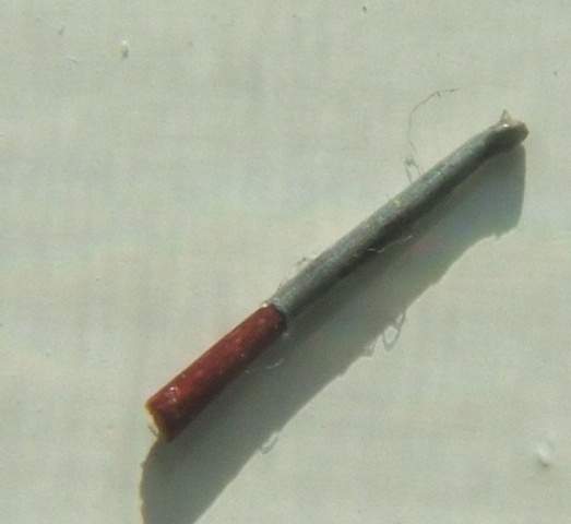

If the cantilever is sheared off relatively cleanly, then it is possible to effect a repair using a splint.
I picked this method up from a member of another forum, tried it and it certainly can work.
A Cactus Thorn is pretty much the ideal splint, small, strong and easily formed.
Form into a spike at both ends and cut off and glue into stylus end of the cantilever (I used UHU for this)
The below pic was a work in progress, not yet glued in place, just checking the stylus side fitment.
Carefully holding the assembly with tweezers, finish off the exposed end of the thorn into the required form by rubbing on some fine sandpaper.
Set up the cart (if MM/MI with cantilever holder in the cart body) in some form of holder such as a small vice, it must be secure.
Once you're happy that the cactus is formed acceptably and it mates into the broken cantilever stub, apply a dab of glue to the exposed thorn and insert.
Use a pocket scope (or naked eye if you're up to it) to set it square then leave to dry.
In this case I ended up using Super Glue as I only had a very small amount of cantilever stub to play with, I had to move quickly to get Azimuth correct before the glue set.
You do need a fairly steady hand, but generally you don't have much to lose in these circumstances so always worth a shot.
As I say it works!
Maybe something to consider Wayner - Good Luck!

DaveyW
Re: Cactus Thorn Cantilever Grafting
« Reply #5 on: 28 Mar 2011, 11:32 am »
Thanks Guys  :oops:
So, how's it sound, Dave?  :!:
Good question and before I answer it I'll need to give a bit more background.
There's a bit more to this particular grafting application - in this case the diamond/cantilever is applied to a different carrier.
Bit of a long story but the stylus used here is a nice nude 8MR, but I was not happy with the suspension.
The treble had started to deteriorate following some potting exploits - Part of the beauty of keeping recordings of all of my carts.
Bammer sent me a busted G2 stylus body, snapped off towards the base, so I had a go at mating the pair to fit to one of my HO Grado bodies.
So it ended up as a truly Frankengrado combo (Z+/G2/8MR).
How it sounded?  - First reaction was  :o - Really dynamic and alive, retaining the bottom end punch and extension that I was used to.
But, it became clear that the top end had become accentuated and a little too hot for my tastes (sort of AT territory).
I believe the driver for this is a slight mismatch in delivered overall cantilever length.
The stub of the donor carrier is a little longer than the 8MR and even then, there's a slight gap between the two.
Upshot is that the cantilever in this case is approx 1/16" too long - I think it is this that is driving the hotter top end.
But - Once again resistive loading came to my aid. Dropping down tamed it nicely.
Perfectly acceptable and for me more than a match for a Grado Gold.
I'm pretty convinced that if you mated the same two halves back together then you won't have lost too much.
The key lesson I learned here though was, for future applications, to make sure the original cantilever length is maintained (pretty obvious really).
I'll try and dig out and load up the clips later tonight so you can hear for yourself.
Cheers
Dave

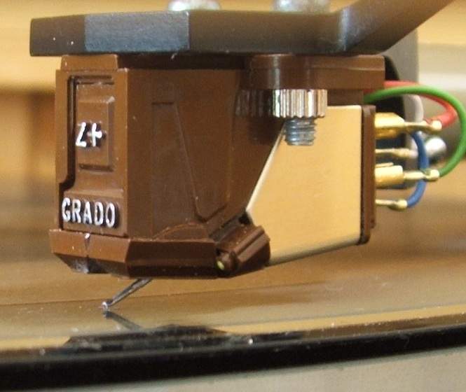

Just finished bending back the stylus....what do you think from the photos? It works, but I'm sure things are not like the original, tho I used one to gauge what I was doing to the damaged one.
The great tool to use for this was the plastic straw that came with my Deoxit-5 contact cleaner. The stylus fit in the ID of the straw and I could use it like a "wonder bar" to bend it (carefully) back to something that looked like the original shape.
This one will go into the wife's TT, as it is seldom played.
Wayner  8)

Nice Job Wayner – Not a kink in sight!
Re. the grafting approach and adding mass to the cantilever, I’m sure it will have some form of audible effect, but if it’s already trashed you’ve got nothing to lose.
Worthwhile giving it a go and see what you get.

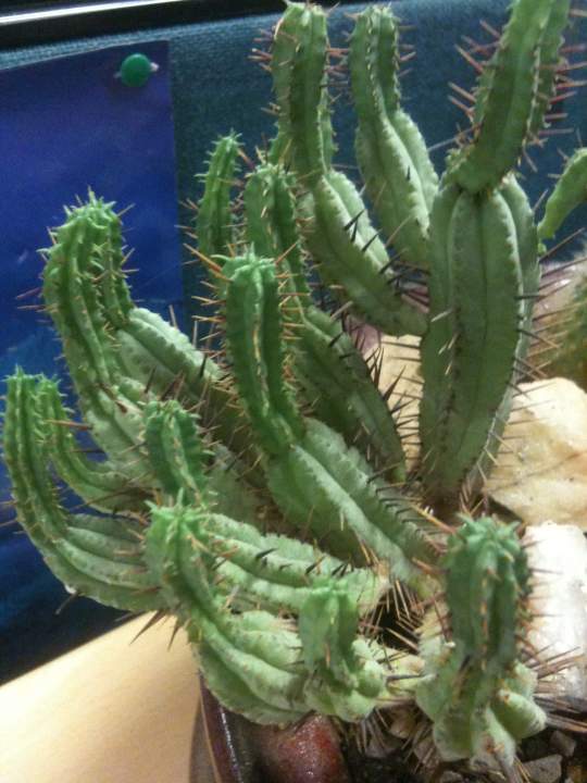

The pictured cactus thorn is actually home grown here in England, I have no idea of the type.
I'll take a pic of the donor and see if our esteemed membership can verify this sonic gem.
I'll get you all back :icon_twisted:

OK Cactus Officianados - Here's the donor
Any one got any ideas of make and model?  :)
