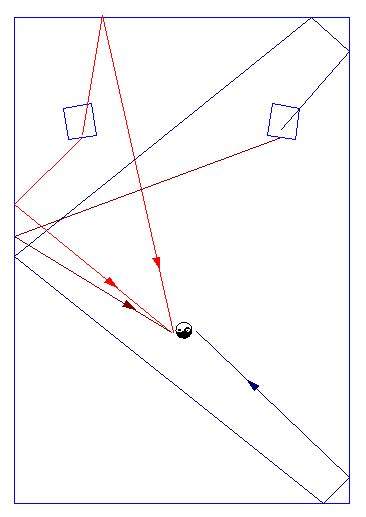

I did a quick and very dirty line drawing of ray tracing for reflections in rooms... don't laugh.  I used the computer equivalent of crayons to do this:
What you see are direct (first order) reflections in reds and lower order reflections in blue.  The ones to go after with absorption or the red guys.  These are the ones that will smear an image.  The reflection will be delayed about 1 millisecond per foot of flight time.  This is a BAD thing.  In the studio I often use a method of panning the instrument called delay panning.  Yep: delay.  It only takes a few milliseconds to move an image in the soundfield.  This makes the image, instrument or voice seem larger than life and a bit louder due to precedence effect.  Precedence effect says (basically) that arrivals between o-25ms are perceived as the same event.  Unfortunately, this screws mightily with localization in the soundfield (image).  The lower order reflections have lost a lot of energy and are what we hear as ambience.  These are the ones that will benefit the most from diffusion... this includes the area centered between the speakers.  This will not normally produce a direct reflection and needs to be diffused to maintain the energy in an uncorrelated form to eliminate the "hole in the middle" that absorption will produce.
Go get 'em.   8)

Re: Room Treatment 101 or what do we hear from here?
« Reply #33 on: 14 Mar 2012, 06:33 pm »
A picture paints a thousand words said Gates....hey his first name was Dave also
Aside from answers to the preceding post I see now why you suggested diffusion behind and outboard of OB. I followed this advice from Dave but haven't addressed first order absorption completely....when placing diffusion behind the Vs as
Pictured above, I may not have got them back far enough...so it appears the blue lines call for diffusion where I was thinking absorption behind the OB, though the corners could use some front side for
Different reasons.
As shown, where the crayon lines point to rear wall corners, some  is also called
For. So as with diffusion front and between speakers, my bet is these diffusion panels should be pushed higher toward ceiling....this makes sense as those woofers could care less at those wavelengthsl

Dave......those secondary reflections could really be drawn in many angles. correct ? When I trace a mirror off the wall behind the Vs, I see it striking right at the spot of first reflection ! So, this means I need absorption and diffusion at the same spot. I removed the Diffusion behind and outside the Vs, because even when stuffed lengthwise to and across the ceiling from mid wall, they produced no audible difference.
However, I moved the 2 pictured above between the speakers to with 24" of Vs rear. The voice image now has the proper height. Then I stuffed 4' length of Roxul mid wall up into the ceiling intersect at corners behind the diffusion panels. Wow, things are really good. despite the Jupiter upgrade, this really tones the Coaxs down in that stridency frequency zone. The instrument bodies, piano and acoustic guitar are more believable than ever. I do have the rear corners stuffed similarly with Roxul along with the diffusion panels centered. The room is as "quiet" as I would like, as with you, "live" is good. When using White face board at ceiling/corner intersects, you have mentioned 36" as large enough for the triangle's longest chord and that a cotton batt surfacing is of benefit. How "critical" is the sizing and surfacing if one were to poly fill the void behind such treatment ?
With all my treatments to the Vs going to the ceiling, perhaps a try at simply doing a ceiling intersect strip about a foot wide, with duct or a fiberboard type, would be far simpler........
PDR.....if you're looking in, yes, I see NO need to be pointing the Super Vs on any acute angles. The waveguide is an asset and the damn speakers look alot nicer standing as furniture and not glaring down at you like the barrel of a gun. Mine are toed 1 1/2", and could just as well be 3/4". I suppose there might be an "ideal" toe, but it would have alot more to do with subsequent wall treatment fore and aft, than with the sound quality to the listener.
