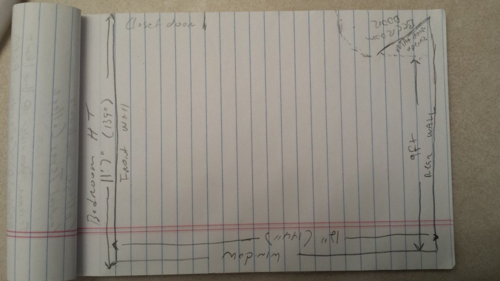

I'm considering utilizing a pair of Magnepan MG1.7i in a home theater set up but concerned whether or not this room is too small. What is Magnepan's recommendation/thoughs? The ceiling is 8ft high. Looking to have at least a 5.1 system, perhaps even 7.1. Postive/negative responses welcomed.

Thanks Steve. Additionally, I'm visualizing using the MMG-W for side/rear surrounds along with a CC5/DWM up front. Audio equipment by either NAD or ARCAM along with Emotiva power amps with a Rhythmic sub rounding out the bottom end. I would like to do a projection system but wondering if the height of the 1.7i will interfere with the projection. I think in this room, the 1.7i can only be placed a max of around 1.5ft~2ft from the front wall. Hmmm...your thoughts or rather Magenpan's thoughts...hehe  :D

Wendell is probably still sleeping off Thanksgiving but if you're only pulling the speakers 2' out from the wall I don't think you'll be too happy with the sound.  You want 4 to 5 foot out into the room.
The DMW/CC5 combo should be real good, the MMG-Ws are okay but nothing wonderful.
MMGs on hinges would be a better choice (I have both so an A/B comparison is real easy).

It would be nice if they had a model that would work about 3 feet from the wall, I got to try a pair of 1.7i, what a nice sounding speaker but to work their best they were out 6 feet into the room.   (14x25x10)
In my experience, 3' is actually OK -- you get more depth at 5', but I could live with 3' if I had to (and have at times). However, on-wall mounting might be a better solution. As Wendell pointed out, you want to maximize the path length of the reflected back wave for the best possible imaging. Ideally, the first reflections reach your ears more than 10 ms after the direct sound. At 3' out, it's roughly 6 ms, which will compromise spatial reproduction a bit. With the wall mounted speakers, the back wave will skitter towards the side walls and reflect from those to your ears, so whether you get more or less of a delay will depend on where you have to mount the speakers, which will depend in turn on room geometry and screen size. If you figure out where you're sitting and go for a standard 60 degree stereo spread, you can figure out where the on-walls will go. Then pretend that there are mirrors on the side walls -- angle of incidence equals angle of reflectance -- and that will allow you to calculate the path length to your seat: sound travels at roughly 1000 ft/sec so each foot will give you about a millisecond of delay.
You can ameliorate the effect of the 3' distance by putting QRD diffusors at the first reflection points on the front wall. If you get a motorized screen, they could live behind the screen -- they won't work obviously when the screen is down (unless you get an acoustically transparent one), but that won't be much of a compromise when you're watching movies or TV, it matters more for music.
You won't be able to see over the tops of the speakers nohow! If only one or two people are going to be watching, you can put the speakers to either side of the screen (still 3' in front of the wall of course) and still get a nice size screen with a field of view that meets SMPTE specs. I did it with a 114" screen and a pair of MMG's and it worked fine -- floor standing Maggies can be within 2' of a sidewall or even closer if you equalize down the bass a few dB. OTOH, if you're going to invite the neighborhood and have theater-style seating, you'll need to space the speakers further apart (> 60 degrees) and you'll need a center channel, which you need for theater-style seating anyway to anchor the dialogue.

I'm one of the minority who think the whole "maggies have to be out in the middle of the room" is BS. It's a "nice to have" not "must have". Same with "Maggie's need hundreds of watts of power". Again - nice to have not must.
If you do have them close to a rear wall use some absorption behind to address excessive back slap of sound messing up sound coming from front. Same holds true for other dipole planars. I've purposefully used sloppy language to describe this.
I've been a bit disappointed with mmg-w and CC's. They just don't extend down enough in the low frequency even for surround duty and much less for CC duty. Yes - you get the wrap around dipole affect which is nice. But because the  LF is so lacking the receiver / pre pro sets the crossover point too high (like 200hz) and then your sub starts trying to play it back (bad). You end up having to manually set the crossover point on the surround lower to compensate or else you get this muffled dialogue coming out of the sub.
So I would echo SF that for side surrounds use MMGs full size on diy hinges. This what I do though it takes some work and they are big. For rear surrounds I have compromised with MMG-Ws. Still a lot of material that's not native 7.1. Its more for fill in effect so I dont sweat it as much.
The Maggie CCs have been the biggest disappointment. Adding the DMW is kludgy. And adding the cost of that ANd CC5 gets expensive. If you have the space I'd recommend the MMG on its side. I tired that once (before using it for side surround) and it was the best by far. Even if you only use one it's still only $600 a pair. You could probably resell the other to someone else who wants to do the same.
Continuing with my CC rant - Maggie's are so revealing that I'm finding often on programs the CC sound is so badly recorded that I think my CC is broken. Distorted / honky / etc. Sometimes even within the same blu ray movie - good / bad / good. What I've come to realize is that it's not the speaker but the recording. The MMG is in some ways "warmer" than the QR based CC5 so it's actually more forgiving. I would look at placing absorption behind it though as it's not practical often to place a CC too far out.

I agree with jarcher.
I've owned maggie 3 series a couple times. They sound great but who has a mansion or a wife that will put them way out in a room?!  Put close to wall, enjoy and slide out into room for listening session if need be.

When I owned 1.6's I tried them anywhere from 2-5 feet into my room.  I settled on 40 inches as ideal for me.

Good answer from mr_bill.
That partially covers Wendell's question which is do they look too big?
If looks aren't the issue, the question is are they too big acoustically?  If that's the question, I'd say not at all and I would also say to give Wendell a buzz as he's been at this a long time and can set these things up in his sleep.
