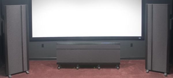

Here's a photo from the Mye Stand website which is what I'm thinking of:

By the way, re the picture with the sideways center, Wendell tells me that a conventional full-sized panel works fine as a center channel. This is for conventional three-channel; I don't know whether it would work with tri center, since the Maggie centers are cardioids rather than dipoles.
