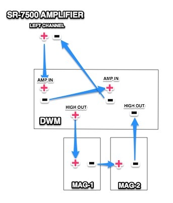

« Reply #220 on: 28 Jun 2014, 04:14 pm »
SkyCap:
www.magnepan.com/www/images/DWMwiring.pdf
You are looking at the first setup. Think directional flow "+" to "-".
Disconnect everything! and connect .....
= Amp Left Out + > Dwm Amp In Left +
= Dwm Amp In Left - > Dwm Amp In Right +
= Dwm Amp In Right - > Amp Left Out -
That's the 8 Ohm series connection from the Amp to the Dwm.
Same style for the DWM to the Mini's
= Dwm High Out Left + > Mini_1 In +
= Mini_1 In - > Mini_2 In +
= Mini_2 In - > Dwm High Out Left -
Or you could buy 4 channels of 4 Ohm capable amplification and follow the original diagram exactly ( times two : )
Shawn

SkyCap:
You are missing one connection on your diagram, to complete the 8 Ohm circuit you also need to "serialize" the inputs to each DWM panel, similar to the "-" > "+" on your Mini pairs.
My other concern would be the Mini's placed side by side, the tweeter spacing may lead to horizontal treble comb filter interference. The Mini's might work better stacked on top of each other.
Your receiver has line level outputs, start saving up for a good quality used amp : )
Shawn
Your input is very interesting...very interesting indeed! :wink:
Thanks and I have revamped the diagram for one set LEFT Channel. Then I would repeat for the RIGHT channel.
Let me know if this is what you meant for wiring configuration. I'll consider the vertical stacking for the mini's.
Take care.
Skycaptain ovr & out

You didn't ask me, but I'll tell you anyhow :icon_lol:. The Mag-1 and Mag-2 should absolutely, incontrovertibly NOT be placed side-by-side. That will unquestionably created horizontal lobing, and comb-filter phase cancellation and frequency response problems. If you stack them vertically you will have created a nice line-source speaker, increasing the two panel's output without creating any of the aforementioned problems.

SkyCap: Bingo(ish) ...
The only ambiguity in your drawing is the final return path from mini_2 "-" to the dwm "-".
Without knowing the details of the DWM's internal high pass circuit, the safe bet would be to leave both of the DWM's  High Out Rights unconnected. and connect Mini_2 "-" > DWM  High Out Left "-".
In theory there is no difference between theory and practice. In practice there is.-- Yogi Berra
The more I think about it, the more I would run the final version by the Master.
Shawn

SkyCap:
I think "Yogi Berra" wins this round, "In practice it doesn't work."
The DWM has internal passive crossovers that are expecting a specific load, start connecting things in series or parallel and the anticipated load values are out the window.
The crossover points will be moved off the intended frequency.
I see a new (used) power amp in your future.
Shawn

Damn those Yankees!!! No doubt you seem quite knowledgeable on the topic Shawn, but as I started out on this quest, I will await an input from the factory guys. You never know they may come up with have a solution....like get an compatible amp! :duh:
