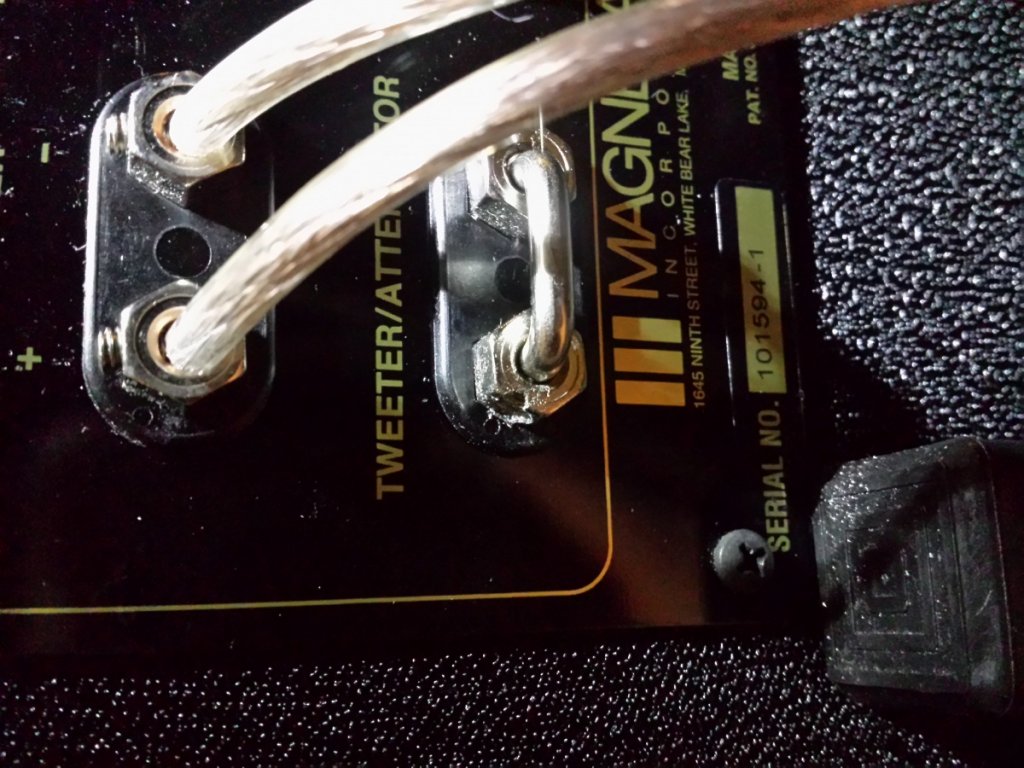

Hi All,
Does anyone else have a broken tweeter attenuator as shown in left attenuator under the +ve speaker cable in the attached picture? ATM the locking screw has completely fallen off and cannot kept in place let alone be tighten.
Am I the only one to suffer build quality issues with the Maggies? Are the maggies supposed to be this fragile?
 :duh: :scratch:

Hi All,
 :duh: :scratch:
Are the speakers old? It appears (from the photos) that the connectors have suffered from a number of traumatic events.

« Reply #207 on: 21 Jun 2014, 02:52 pm »
I just received them barely a month ago nicely packed from the dealer with the magnepan seal intact. Is it possible to check the age of the panel?

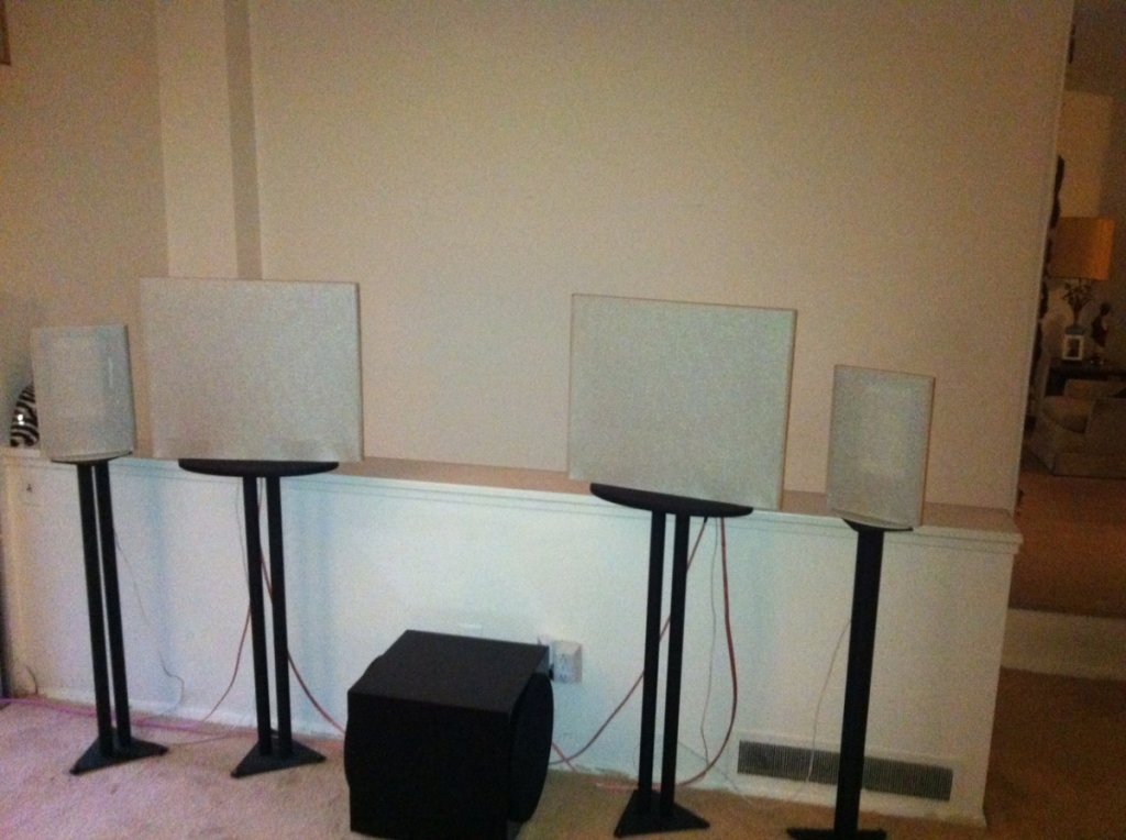

To give you some idea of how the Mini Maggies might look like in your living room.
If I had to make the setup look more attractive I would hide the speaker wires and ditch the sub. Also, the speaker stands are cheap and functional but if I wanted something more attractive I would opt for natural wood stands or spray paint the metal stands white or a color coordinated with other colors in the living room.  Actually because I have a low wall in my living room about the same height as the speaker stands with 3 feet behind, I do not even need the speaker stands since I could sit the speakers on the low wall. IMO for an attractive living room no other audio equipment should be in the living room.  All my audio equipment is in the basement along with my reference speakers.

To give you some idea of how the Mini Maggie's might look like in your living room.
A most prodigious effort Sir Robin, thanks for taking the time to show me a possible set up.  :thumb:
I think you may have something here that could work. :D.  I Like those stands as well. Where did you get the ones that the DWM's sit on? They look wide enough to connect (x2) mini Mags on each. Do you think the DWM subs could be positioned down and away from the main drivers? Or do you feel that the DWM subs do not extend bass adequately and that's why you augment with the additional powered sub? Or was that a possible option you showed me for looks?

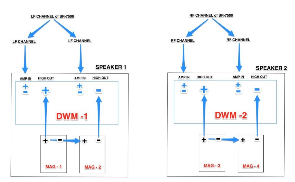

Now I just need to know if I can hook two mini Mags in series to put an 8ohm load on each R & L front channel of my amp.

The Mini Maggies are the most impressive speakers that I have heard from Magnepan since the Tympani IVa and for the price they can't be beat. Many of the other larger Maggies sound good but I was never impressed with them to spend money and I knew if I got them I would always be wanting more. That said I haven't heard the 3.7i or the 20.7 speakers, so I can't say that those would leave me wanting. The Minis are very special and I knew I wanted true ribbons and the bass technology from the 20.x speakers.
The DWMs are woofers, not subs, since they only go down to 40Hz. I believe the DWMs cross over to the midrange/tweeter panels around 250Hz so there is a lot of mid bass. So you should not locate them too far from the midrange/tweeter panels unless you locate the DWMs centered between the left and right speakers.
The speaker stands were from Pangea, nothing special but cheap about $50 on sale and I filled them with steel shot. I actually use the same stands for my Audioengine 4 speakers in a home theater system in another part of the house. The satellite panels are attached with Blu tack but the DWMs are bolted to the stands so you may be looking at the DWM wood base. That said it is easy to bolt a wider plate on any speaker stand to support two satellite panels. I had originally planned to develop a custom stand to support two satellite panels vertically (optimized for seating and standing positions) with one DWM below for each channel.
The sub in the picture is a Genesis G-928 bipole sub and I use it because I have multiple dipole and bipole subs. Does it make a difference - yes, is it worth the money - yes, is it absolutely necessary - no.  But because of your WAF concerns I would go with either multiple DWMs or in-wall BG Radia subs as your funds allow.

How do Sir Robin, I own x4 DF24's already so thus my reference to that particular stand. The SR7500 is rated to 6 - 8 ohms and that the 4 ohm loads for the maggies could ouch the amp. :nono:
However I'm not going to modify the Maggies and risk a warranty void, but simply change the connection sequences between them and my amp to bring the realized load to 6-8 ohms. See attached image for what I think will work.

SkyCap:
You are missing one connection on your diagram, to complete the 8 Ohm circuit you also need to "serialize" the inputs to each DWM panel, similar to the "-" > "+" on your Mini pairs.
My other concern would be the Mini's placed side by side, the tweeter spacing may lead to horizontal treble comb filter interference. The Mini's might work better stacked on top of each other.
Your receiver has line level outputs, start saving up for a good quality used amp : )
