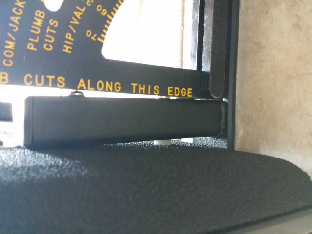

Hi Steve,
I have recently bought the 1.7 from the australian dealer (Mcleans) and one of the feet is not upright as shown in the attached:
Hence when installed the feet is at a different angle than the others resulting in an unbalanced speaker. This is like putting 2 of those provided spacers on one feet and none on the other. Is this a normal occurrence?

Hi Steve,
I have that on one of the 1.7's as well.

« Reply #196 on: 2 Jun 2014, 01:48 am »
How did you resolve yours? Did you get a new foot?
No I settled with putting something under the foot to keep the speaker from wobbling. Could be improved..
It is not straight because of the weld below. I assume that the part of the feet contacting the floor is uneven also. Take it out , put a larger tube on the aluminium feet and pull it out.
Easy task, just be careful not to stratch the paint.
These feet are made pateticly and they still dont want to change it..
