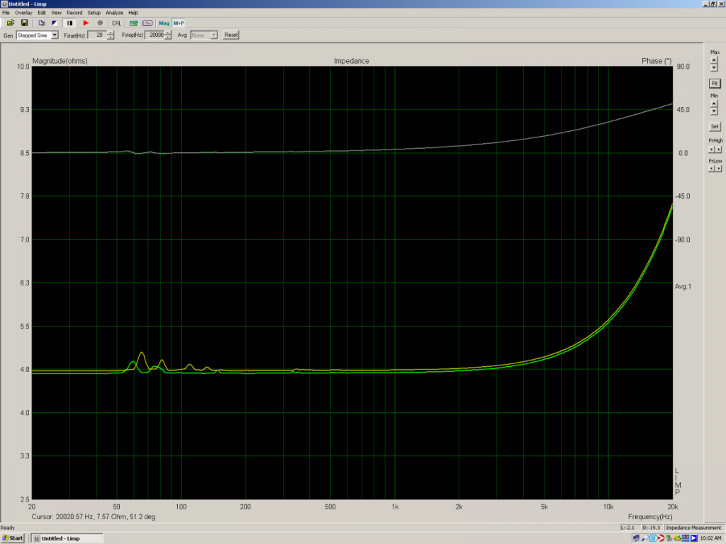

I've seen some 1.7s (pics and in person) and the tuning dot spacing is different on each speaker.  How do they determine the spacing and why wouldn't they be symetrically placed? (ie. same spacing on left speaker as the right speaker)
I'm pretty sure it has to so with spreading out the resonances of the membranes btw the left and right speakers, so there not one strong resonance.  Large planars are really like a stretched drum head, so you can imgine that they resonant just like a drum head.  Ever seen a drummer put little squares of tape or foam on a drum head?  It stops some of the ringing and overtones.  I imagine the dots are doing the same thing.

The answer is right here (in another thread) fellas.
http://www.audiocircle.com/index.php?topic=110161.msg1146057#msg1146057
Same reason on the larger speakers as on the MMG's.
Dave.

Here's a photo of the impedance sweeps of my left/right (woofer only) MMG panels.  Notice there are six different peaks and the two lowest frequency peaks from each panel do not line up with each other.
Hope that helps.
Dave.

@ Davey:
 :scratch: Pardon my ignorance, but why would spreading out the impedence humps affect the sound?  I can see an impedence bump affecting the flow of power from an amp, but why make the two channels act differently, especially since the bumps seem minor (at most 0.3 ohm difference).

« Reply #130 on: 28 Oct 2012, 06:19 pm »
It's not really the magnitude of the impedance peaks that are of interest.  Since these are transducers with much less powerful motors than conventional drivers....and they are essentially resistive....the magnitude of the peaks is not indicative of the SPL rises created by the membrane sections.
If I were to take six different measurements with the microphone very close to the center of each of those "sections" you'd see a much more exaggerated effect.
An impedance sweep is a much easier way to determine their frequency.  You can see visually the resonant frequency of each section and not deal with all the variables (and spend all the time) involved in SPL measurements.
It's not easy to subjectively evaluate the effect of the tuning buttons since most folks only have one set of speakers.  I have two sets (actually three  :)) sets of MMG's and I've auditioned two left speakers and also two right speakers.  The two pairs sound different from each other in the bass area.  I have to attribute that to the sympathetic panel tuning you realize when pairing speakers like that.
The power amp (a good one) couldn't care less about small impedance peaks like this.  It's functioning as a voltage source and the very small current changes at these resonant points are minor.
Hope that helps.
Dave.

@ Davey:
Thanks for the quick and detailed reply.  So these peaks serve as a "fingerprint" of more significant audible dips and peaks.  Makes sense, but I wish at times like this my engineering training was in electrical vice structural...  :)
