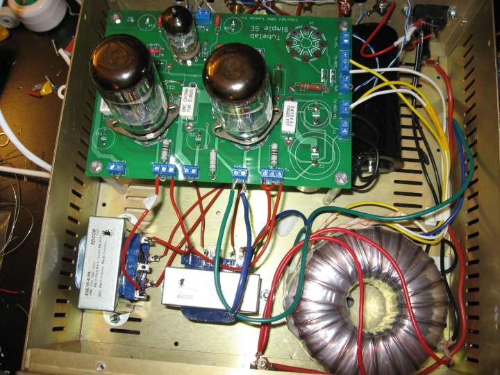

Just fired her up. My first DIY tube amp. Aside from some basic duh wiring errors and slicing off the tip of a finger, this was a pretty easy build :roll:. The kind that having done it once, I know I could do another pretty quickly. I am really fascinated by tubes, both aurally and historically. Will be a few days before I'll be able to try it out proper. Not very attractive for now, but whatever.

Another SSE builder.  :thumb: Not going to ask about the thumb :scratch: but suffice it to say I managed to shed some blood with my builds but after completion it was well worth it.
I see from the board that you are using the solid state rectification. Might I suggest grabbing a octal tube socket and get yourself a Sovtek 5AR4 and just go with tubed rectification. The sound is so smooth and wonderful. You might get a bit more power from solid state rectification (I'm getting 8 watts @ 5% THD in SET, so I doubt it) but the more tubes the better.
Also give the UL option a try it's not quite as wonderful sounding IMO, but you will get 15 watts possibly a bit more.  :thumb:
Also looks like you're using 6550s, give some KT88s a try.

hey pez. the transformer doesn't come with 5v rectifier winding but that's okay i'll explore all that later, flipside is it fits in this enclosure easier than an edcor would. i wanted to start very basic and then go from there, add choke, cfb, ul switch, etc over time...

That's the great thing about the SSE, it's very flexible and allows so much experimentation. I definitely was able to dial in my tastes based on the plethora of options.
As far as the Edcor PT they are big and expensive. Give this one a try: https://www.alliedelec.com/search/productdetail.aspx?SKU=2270013
It's actually a Hammond PT that has been relabeled Allied and is beyond superb. I ended up using it instead on the Edcor because of both price and performance.

Hey nodiak, I did connect to my speakers tonight for a half hour or so. Speakers are only partially set up and consist of 4" Mark Audio EL70 full range sealed. Minidsp and woofers are offline for the moment. That said: G-DAMN! SOUNDS FKNG AWESOME! F@%K YEAH! If it sound this good NOW, sheeeeeeeeee@t. Oh man, I mean aside from the Onix and the Miniwatt and some brief listening to a fellow audiophile's Almarro 205, I don't have much tube exposure so what I'm hearing I'm hearing is nothing new to a lot of people, but I get it now I really, really get it. Whole new level for me. The realism and dimensionality and, it's man, just so different from what I've heard til now. I recall the Almarro being somewhat like that but I only spent a few minutes with it really. The others for sure didn't. Compared to this it's like they're facsimiles. Oh man, the realism of the instruments and effortless flow...
Comparing to the classdaudio is really apples and oranges, 250w vs. ~6w!!! Like comparing lightweight and heavyweight boxers. Ali vs. Sugar Ray? Not really fair, but no the CDA/SDS has not done for me what the SSE did tonight (the DCB1/CDA-254 comes close, but it's an altogether different presentation and my speakers were conventional 2-way with 10lb of crossovers. Each.).
I forgot to mention I'm running the SSE w/:
Cheap Shuguang EL34s, 445v B+
Antec Power transformer
$18 Edcor OPTs (w/ slightly beefier ones on the way)
JJ electrolytics
Obbligato Oil cap in PS (that thing is ridiculously big. sheesh.)
Organic Polymer Caps (similar to Os-con)
Mundorf Silver/Oil for bypass
Takman Metal resistors (I prefer to their carbon)
Neotecch UPOCC wire and Gold/Silver/Copper Alloy wire
Cardas Copper Binding Posts
DH Labs Copper Chassis RCA jacks
Already had the enclosure, posts,  jacks, wire, so I think I spent around $350.
I was running straight from DAC, no pot, using my PC software for volume control. One thing that has me worried is it seems like there is way too much gain, but we'll see when I get a pre installed.
Lastly, the SSE made the EL70s seem far larger, far more alive than with the previous amps. Definitely a match. Like new speakers. Can't wait to build the dual version. Also, despite the tiny Edcors I get some real darn good bass out of those sealed ELs, cleaner and more prominent than with the Onix. Go figure.
And what 2nd order distortion. According to Tubelab sims, should be roughly 9%. Sounds as clean as the other amps. Oh so slightly warmer. Slightly. Maybe the SS rectification adds some leanness, in which case I like it.
