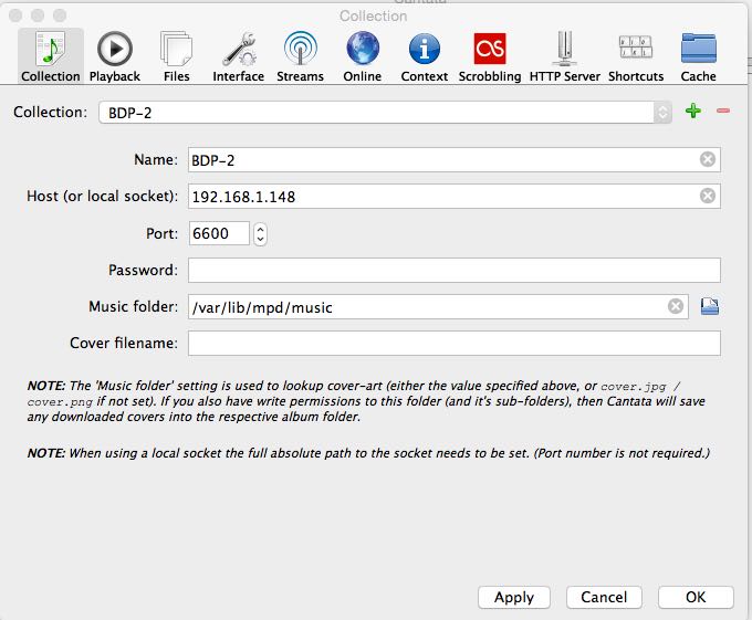

this is what i get frequently:
wifi and lan.
it is the correct port isn't it? 6600

Heres my setup

thanks James,
seems identical to mine... other than the 2 of course  :cry:
maybe it has to do with the amount of music, ill remove my usb drives for testing purposes this evening.
it has definitely got to do with the Folders view on Cantata. The other views show and work fine as far as i can tell up to now. Whenever i click on Folders, the connection breaks. (adding to that, i had the LL interface open , and clicking on Folders resulted in  an empty folder view in LL, bringing it back, leaving the Folderview in Cantata  :scratch: :scratch:)

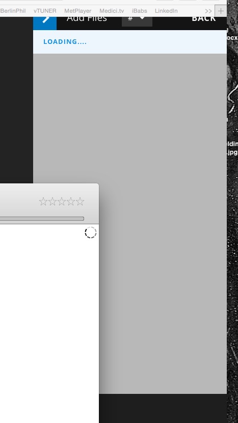

well, that didnt help. disconnecting the usb drives still didn't help Cantata to keep the connection in folders view. Moreover, that effort results in even stranger display of squares in LL:
love the internet-stream functionality though, what a breeze , and completeness is super!

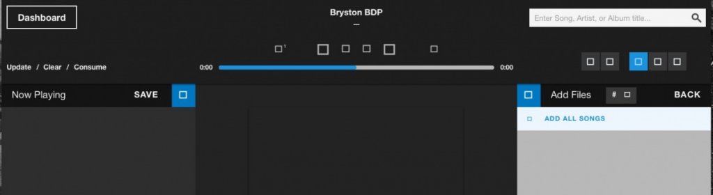

The Bryston media player interface on my iMac suddenly stopped working.   Music can be selected (right hand side of interface) and then appears in the left hand panel, but nothing happens when "play" is chosen.  The front panel of the the BDP1 shows the song and the pause symbol.  But the problem is intermittent - sometimes it works, sometimes not.  Can't figure out what makes a difference in how it operates.
Any thoughts about how to get it back to its old consistent self?  The problem was occurring before updating the firmware to the latest version.
MPD:  18.21  Firmware:  S2.11  2015 - 06 - 19     iMac OS = 10.10.5.
The network is fine (my Touch works); internet connection is fine.   :scratch:

Thanks.  From the Network Interface, the BDP finds the network, but checking Static, for example (I use a static address on my router), and then "apply" seems to do nothing.  When I return to the menu item, neither DHCP or Static are remain checked.  This has been normal operation and never a problem previously.
When the BDP operates normally, the front panel indicates a "N" after it has completed initialization.  When it does not work normally, it gets stuck on "Media player ready."  After using the "clear" command, the front panel shows a "stop" symbol (solid square).
