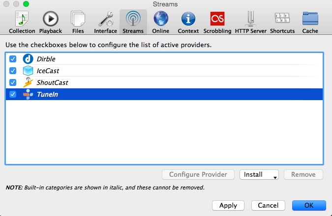

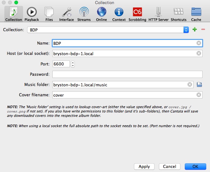

HI All,
Just found out about Cantata on https://code.google.com/p/cantata/ running it on my Macbook right now. Seems a very nice interface, with all sorts of online services (Tunein!)
Preferences:
Its updating the database for a first time, so taking a while, but all seems very promising. Very quick response, although it looses connection during the process.
Anyone with Cantata experience on this board?

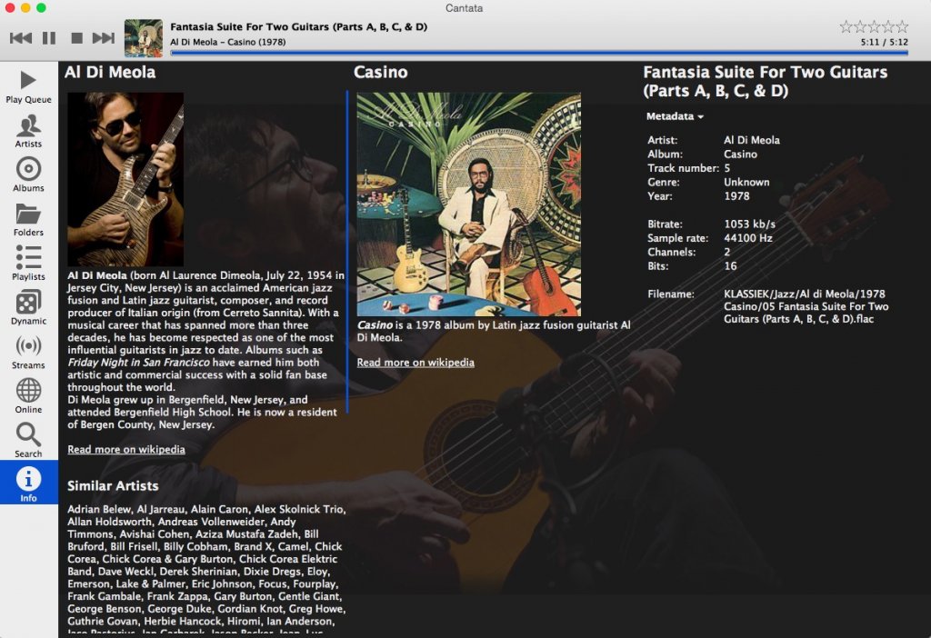

small miniature interface option:
full interface, with some apparent online background info:

some extra info on Cantata MPD player: http://www.maketecheasier.com/cantata-new-music-player-for-linux/
only issue, and quite annoying, is it loses connection a lot. Chris, would you happen to know this software, and have a fix for that, maybe in the settings?
the online services are a big plus on this Cantata interface, and album art is showing nicely.
would really be wonderful to have it keep its connection to the BDP  :scratch:
