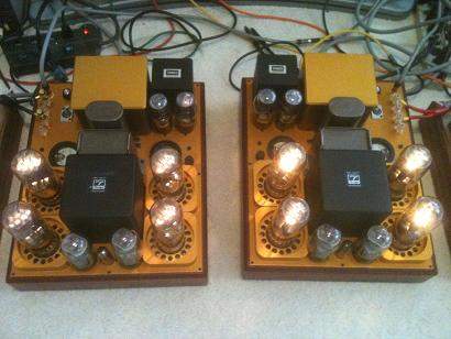

Not a problem. As most of you know I design my own transformers and then have them made for me. The transformers for these amps of course are single ended.These particular transformers are rated for 200 watts! They can take 600 ma dc in the core and they weigh in at 65 pounds each!!! The measured bandwidth @ 160 watts output is -1db from12hz-47khz! This is with 3KV on the plates. They have 4 and 8 ohm taps.Gary
Those cost me nearly $1K for 2 of them. In single ended operation it takes a huge amount of iron to achieve a good clean low end! Winding technics have a ton to do with the good hi end response. I will not disclose my winding specs! Gary
ABSOLUTELY not available to the diy market!!! I am not going be responsible for someone vaporizing themselves!I have had extensive workings with voltages up to and above 100KV capable of several amps and the high voltages do not bother me. Sorry I will not let these out for sure! The 3Kv supply for these is capable of well over 2 amps, definitely lethal! The caps are 100uf @5KV laser pulse caps capable of delivering pulses in excess of 5000 amps! Deadly stuff for sure.gary

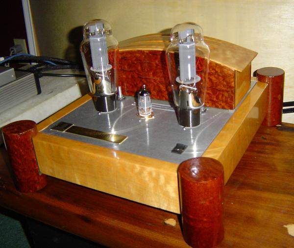

Here is a pic of my recently completed Bottlehead Stereomour............
Ahh....so that's your amp pictured on the Hawthorne site. I wondered who owned that. I think it looks likes like a caboose.Very cool. Bob
Skeeter99 posted this amp before, but not it's at my house and all lit up.
