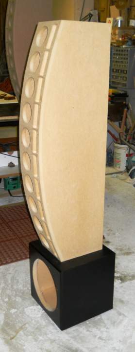

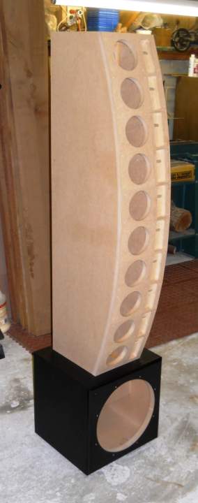

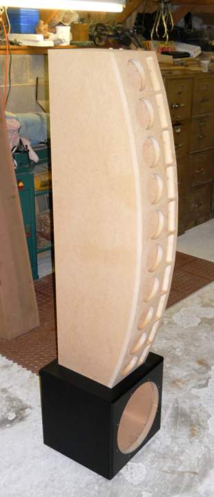

45" tall array (woofer base is 14"x14"). Ten 4" woofers and thirty tweeters per side.
