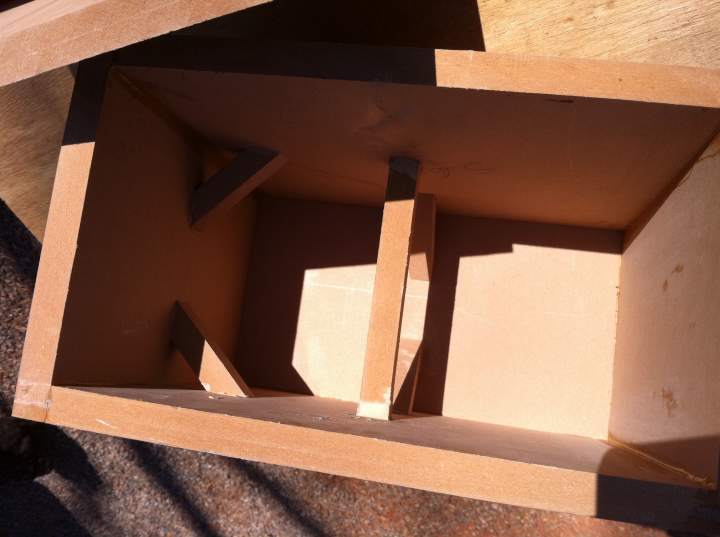

Am new here to AC and the DIY audio space.  I ran across GR when I started doing research for a new bookshelf speaker system.  After a lot of reading and many emails back and forth with Danny, I thought it would be good to start with something simple as a gift, so I'm building a pair of XL-S Encores for a friend.  Have already pinged a few of you for help and you guys have been great.  Ron suggested I start a topic to show the build, so here goes.
I am building the basic plans with no port in the back out of 3/4" MDF and have the basic boxes built and braced:
It was a nice day yesterday, so I glued up the braces outside.
I used regular Titebond II to glue up.  When I do it again, I will either use biscuits or shoot some brads to keep the sides aligned better, they slipped around some so I will have some extra sanding to do.
The plan is to veneer these, which will be a first for me.  And my veneer arrived yesterday, and it looks great.  Tomorrow, I will cut out the circles on the front baffle and on the back panel for the posts.
P.S. couldn't figure out how to rotate the picture so it would be portrait, so if anyone knows how, please let me know.
jeffh
Re: First Time Build X-LS Encore
« Reply #1 on: 28 Feb 2011, 12:43 am »
Looks good so far.  Your going to like those when you finish.  Great value for the money.
I recently built my first speakers (X-LS) and did my first veneer job.  Just take your time,
measure twice and it will turn out fine.
