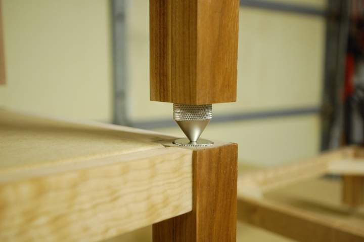

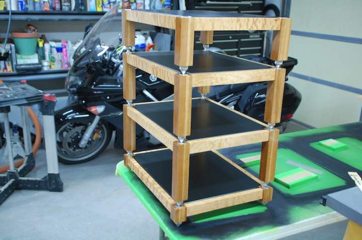

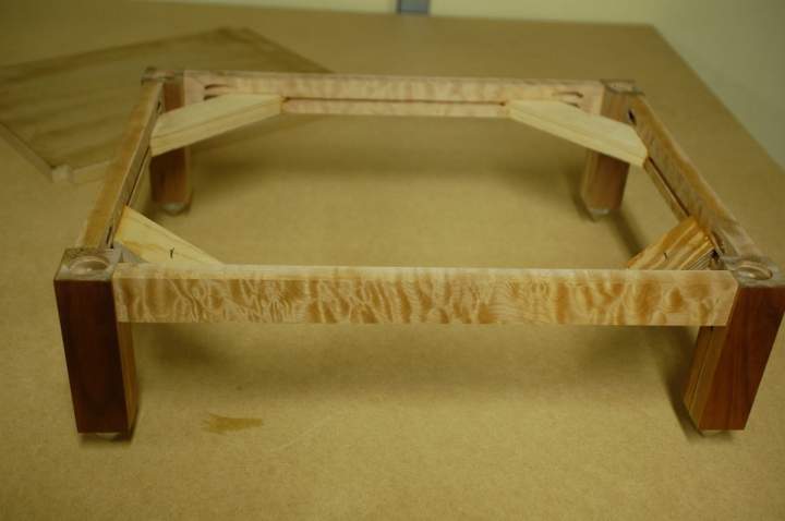

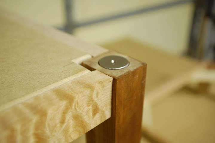

I have been working on my equipment rack for several weeks now and it's finally coming together.  While I won't say it was really "Cheap and Cheerrful", it was fun to build.
The wood used is quilted maple and cherry, no stain was used just clear shellac.  The shelves were primed with Killz using a texture roller, sanded slightly, then spray painted satin black.  The texture almost looks like leather.
The main frame is assembled with pocket screws and corner braces.  The spikes on each leg are from Parts Express, speaker spikes.
Bob in St. Louis
  • Posts: 13276
Re: Built my first rack for very little Yen.
« Reply #35 on: 13 Apr 2011, 09:44 pm »
Nice!  :D
But in all fairness, that's worthy of your own thread, not piggy backing on another guys.
Well done Sir!
Bob
sl_1800
  • Posts: 406
« Reply #36 on: 14 Apr 2011, 12:40 pm »
Thanks Bob but it wasn't really a cheap build so I hated to start a new thread here for it.
TomW16
« Reply #37 on: 14 Apr 2011, 01:59 pm »
Very nice rack SL!  And well constructed too.   :thumb:
sl_1800
  • Posts: 406
« Reply #38 on: 14 Apr 2011, 07:09 pm »
Thanks TomW16.  I have collected several woodworking tools over the past few years so I had to put most of them to use on this project.
