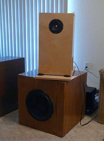

Yes Chris, I'm with you there (on stretching the definition of a sub). None of those 8 inch cube subs or 2 inch cube mains for me. And yes, I forgot the advantage of taking the "heavy lifting" (of the deep bass) off the extended range driver.Sorry for continuing to divert the thread. Yes maybe pictures would help keep the discussion on track.
