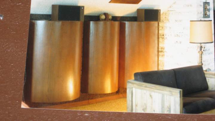

This is what I built for diffusing and absorbing bass behind the listening seat.  They are called poly cylindrical diffusers.
I used tempered Masonite that is stretched over curved plywood members.  These devices are filled with fiberglass and
are completely sealed with weather stripping, providing a airtight chamber.   Different sizes were used to provide bass
absorption and helped to redirect high frequencies.   My entire wall behind the listening position was treated this way and
worked very well.    Not the easiest project but cost was low.
