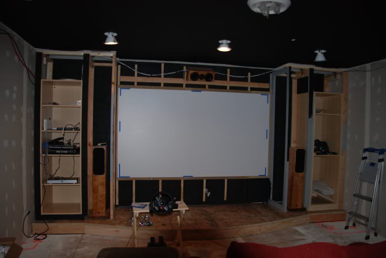

Here is what is currently in the room if that helps give you some idea of what I am starting with.
I am not that concerned with shaking things off my walls nor do I want muddy bass. I would like the sub to play as low as needed to reproduce deep bass found on movie soundtracks but I don't need that feeling of having my chest crushed. I am actually content with the AV-3's I have but run into problems in action movies as they just cant pressurize a room of my size nor play deep enough.

That is a great looking project.  That stage looks very nice and those speakers look like a pro built them.  How big is your theater room?

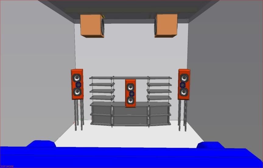

Do you have any areas that you could do an IB sub, perhaps in the middle of your ceiling at the front of your theater?  Then you would not have to build a box.
The single greatest improvement that you can make for your project is to plan on some minimal room treatments.  Treat the corners for bass and contemplate absorbing the first reflection points.  My brothers HT is 3x larger than mine but has no treatments.  I think my smaller room with treatments might have an edge...

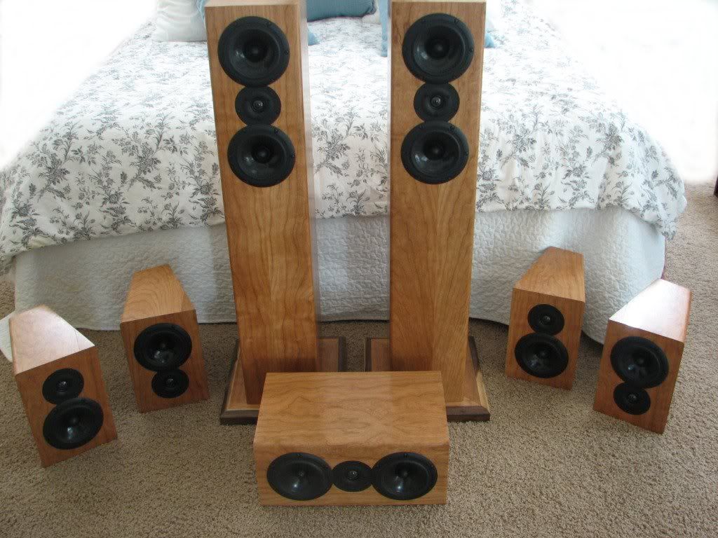

Been a lot of fun so far!  :D
Appreciate the compliment. I'm no pro but have some good woodworking skills.
I have considered this option as there is attic space over the room and to the left of the stage. Here are the issues with IB. It is nearly impossible for me to get to the space over the room. While there is a few feet (maybe 3') I cant really crawl up there due to the blown in insulation. I'm sure I could push it off to the side to make a nice crawl-way but then I have to deal with that and reinsulating it when finished. Also now that I already have 2 SA-1 amps what would I do with them? I know Danny is a nice guy and would allow me to return the amps but I don't like sending stuff back and possibly taking a restocking fee. Could you use these amps to drive an IB setup? From my reading on Cult of the IB website it looks like 2 15" drivers is not enough. There is a possibility I could do a manifold over the front stage and not really ever need to go into the attic. I have a lot of wiggle room with wiring in the room since I'm building everything myself and hiding wiring isn't an issue. I could mount the manifold then fish the wire to the nearest wall (only a few feet away) and run it to the equipment rack, which is on the front wall. Here is a very messy picture of what I have done on the front wall so far. Keep in mind all of this will be covered with black cloth and there will be fabric covered doors covering the cabinets. I really regretted putting the cabinets on the front wall but was really limited on locations in this room and needed an equipment rack somewhere. I worry about controlling the sound on the stage since corner traps aren't really conducive to the way the stage is.

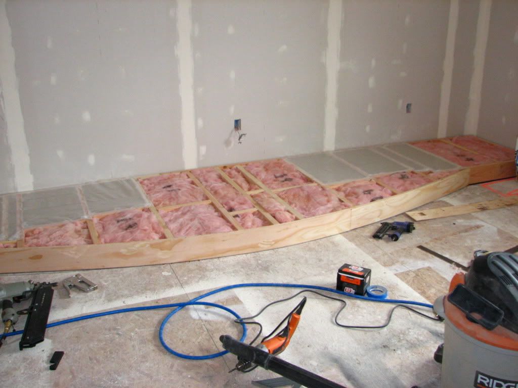

As far as sound control goes in the room. I have Linacoustic RC on the front wall already and plan to have it from the ground up 4 ft. around the perimeter of the room. Above that there will be cotton batting up to the soffit which I still need to construct. I was planning to stuff the soffit as well to add more bass trapping. The room has double sheetrock with Green Glue between it.
You are making me feel IB might be a better option now but I was really shying away from this due to the possible cost of so many drivers and the amp. Maybe the cost isn't all that different. At this point I'm into it $460 bucks or so with the 2 15"s and the 2 amps. Are these drivers good for IB setups? Are 4 MFW-15’s enough for an IB? Could you use the 2 SA-1's to drive an IB setup? Sorry for being all over the place on this project.

T-dog,
 Your speakers look great as well as your new stage area!  Beautiful cabinet work. I have a pair of AV-3's and they do sound great with movie sound tracks. The AV-3's in my opinion are a little more lively sounding without sounding overbright compared to the N3. The N3's have a smoother, more detailed sound quality.

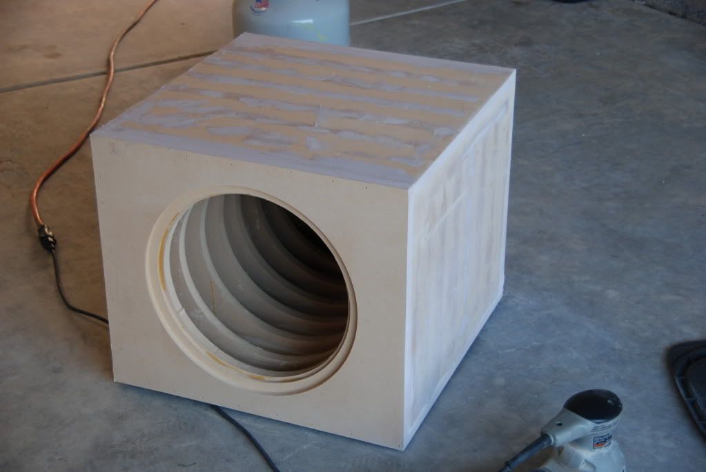

Went sandbox sealed route. Here is where I'm at on 1 of them. The other is half way to this point.
Weight of the box in it's current state completely void of a driver and amp, 115 Pounds.
Getting ready to paint them soon. Goin truck bed spray route. Never gonna see these so I'm going the easy route.  :D
I've thought about that.  I think it will look good and help make the box dead. Are you going to DIY or take it to Rhino Linings, Line X or some place like that?
Nicely made.  :thumb:
