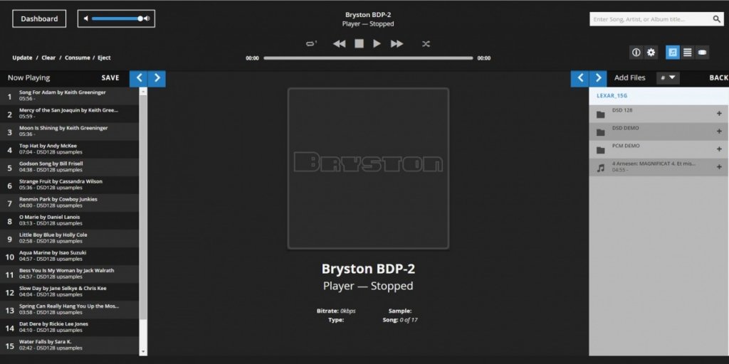

Some folks have asked for a Volume control on the BDP Manic Moose software.   It has to be engaged through the "Audio Devices" tab in Dashboard if you wish to utilize it.
Trying it out this weekend.
james

Hi James!
Does that mean you'll be able to connect DAC's outputs (like the ones on the BDA-2) directly to a power amplifier's inputs without the need for a separate preamplifier?
How is the volume control done and does it affect the audio quality in the digital domain by bit truncation?
Cheers!
Antun

Currently it only controls the BDP or SP3 volume at this point (maybe the BDA3 DAC as you need ethernet control)) and you do loose bits as you turn the level down.  For maximum performance I recommend leaving the volume fully up.  It is really just a feature some people wanted for casual listening.
james
