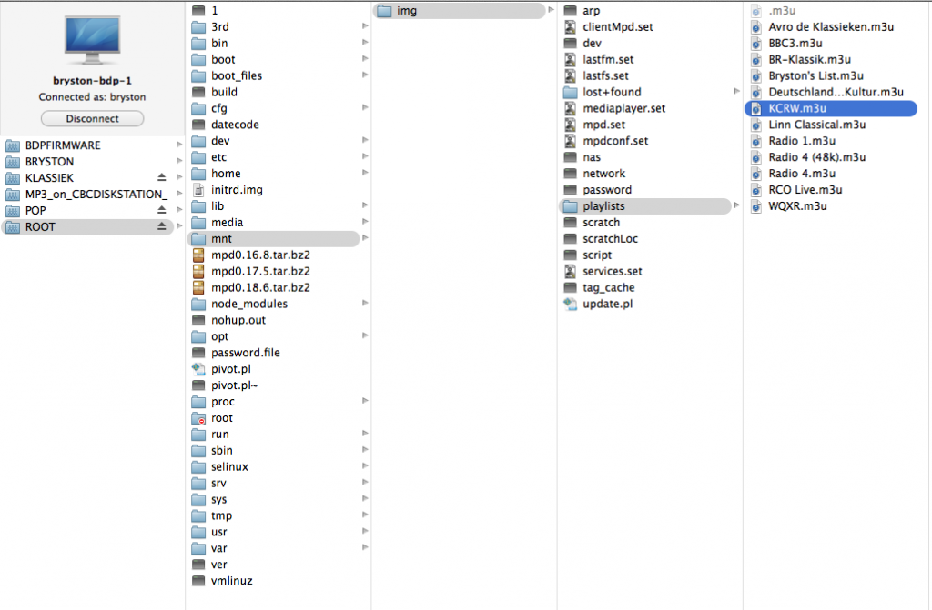

make a textfile with this content, save it as kcrwmusic.m3u and move it to root/mnt/img/playlists. et voila, a playlist with that preset radiostation shows up in the BDP...
edit:  content of the text file should be http://kcrw.ic.llnwd.net/stream/kcrw_music, the former doesn't work in BDP media player.

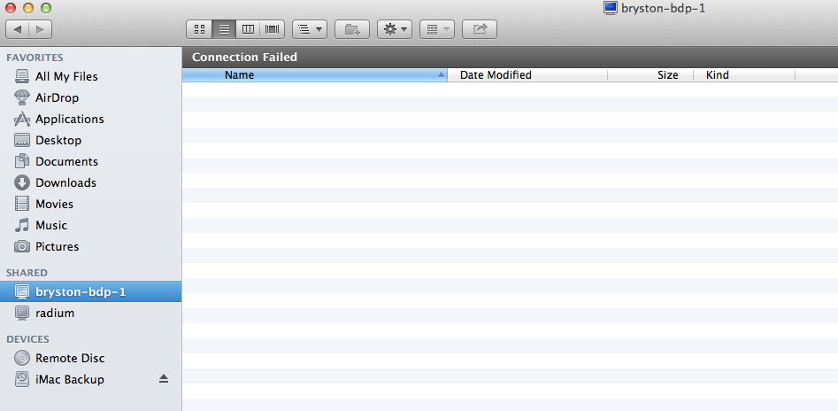

So how do I access this through Mac/Finder??
I can see it, but I cannot connect to it and not sure how to go further.
I've also tried the Go drop down in finder and use the Connect to Server option and was unsuccessful through this approach, so I'm stuck.
Wayne.

let us check some other things:
have you tried entering the ip address into the Finder/Go ?
And, did you try the link in the internet browser? If you see Max interface, that would mean a correct network connection at least, and we could narrow our search a bit..
Do you use any remote system for operating the bdp, or only the buttons on the frontpanel. Mpod/Mpad and the likes.
Marius

I've entered the IP address into finder and it says it can't be found.
Max interface works fine and I can build playlists and such from within there, but I don't see an option to add internet radio stations within Max.
mPad and mPod both connect and work fine with my BDP.
Wayne.

seems to be a Mac /finder issue then, since all other network connections to the BDP work. Have you checked filesharing in the Sharing settings in system preferences? Maybe firewall setting?
one extra check: try Go in finder, connect to server, and type smb://bryston-bdp-1.local if login displays, type bryston twice #fingerscrossed
being able to see Max is a good thing, you can enter the developer mode command then ;-)
Marius

We're making progress…  :D
This is what I'm seeing now and I can access the music on the drive now.  So I guess the next piece is how to enter the developer mode command to see the file structure?
Wayne.

id caution you before doing so. You might want to wait for Chris to enable some functionality for editing these playlists soon through the interface, instead of entering the BDP through terminal-commands.
check http://www.audiocircle.com/index.php?topic=105853.msg1097506#msg1097506 for Chris's directions for entering developer mode, and check that this command should be entered using ssh command and not the startup script. read carefully what Chris writes on that subject.
I would advice you to ask Chris if this still is the preferred way of entering developer mode, to reveal the root on the BDP, to be able to write the playlist folder.
Marius
