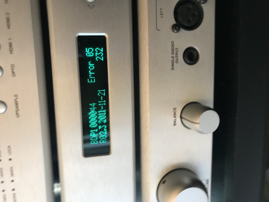

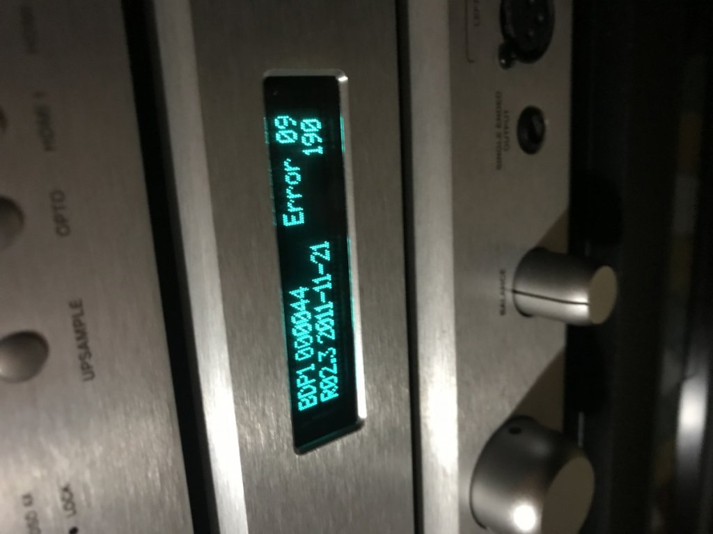

Hi
I corrected my BDP-1 09 error by changing the cr2032 internal battery
Help, I have a problem with the BDP1 USB, as a rule when I turn on the BDP1 I get error 05. I turn it off and turn it back on and error 09 appears. I have to turn it off and on several times until the errors disappear but since yesterday error 09 always appears. and every time I turn it on I keep getting error 09.

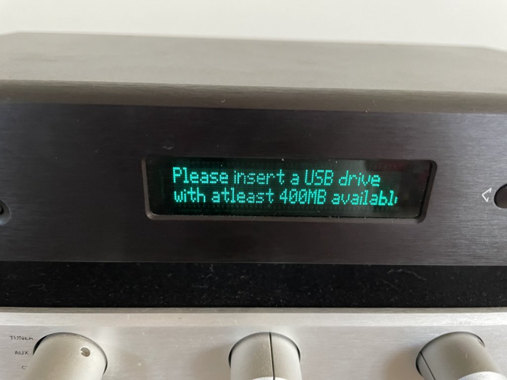

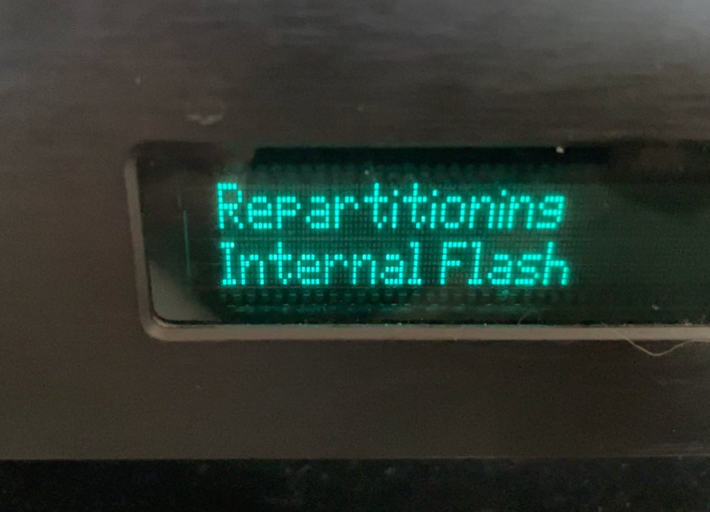

Hi there
I've got, what seems to me, a strange problem with my BPD-2. It wasn't responding to the web interface so I went to reboot it and saw the message 'Please insert a USB drive with at least 400mb available'. Wasn't expecting that. I tried rebooting it and after the boot up sequence got the same message. Prior to that a screen very briefly flashed up saying 'Repartitioning internal flash' .
I've tried rebooting with a suitable freshly formatted usb thumb drive plugged in, and also rebooting and plugging in the same usb thumb drive. Nothing seems to get me off the 'Please insert a USB drive with at least 400mb available' screen.
Has anybody got any ideas what's going on here? this seems to have sprung out of nowhere with no 'provocation'.

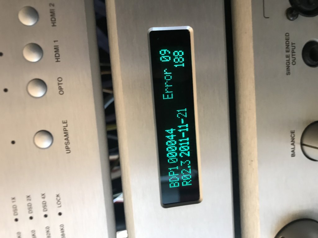

« Reply #1649 on: 4 Jan 2024, 04:29 pm »
Recently developed a 09 error when booting my bdp-2 which disappeared if I disconnected my ssd. I have removed the drive and copied all my music files to an external hard drive. (Yes I should have backed up before now!!) The ssd is now connected externally by USB. All music appears to be present and no 09 error. The suggestion from tech support (thanks) is that the ssd has corrupted Linux system files and should be re-formatted before being placed back into the bdp-2 with the music being copied back from my backups.
I am hesitant to do this because if the backups have not worked I am totally screwed. I was wondering if there was any way in which the corrupted Linux files could be recovered/replaced whilst leaving my music intact? I must add that my knowledge of matters Linux is totally zero.
It did also occur to me that this may be warning that the drive may be on its way out and I should invest in a new one
My last encounter with Error 09 was solved by replacing the CR2032 coin cell on the motherboard.  The Linux system files are on a CF card and not on your storage drive so we may be dealing with a misunderstanding somewhere. It still wouldn't hurt to copy your music files in case some sort of file system corruption occurred on the SSD somehow. I'm not a programmer so unfortunately, I can't speculate on the cause or nature of your issue. If you're still having trouble, email Adam, [email protected] and see what he says. He's a smart fellow. :)
