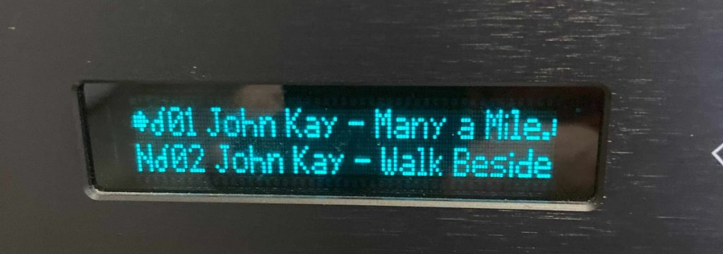

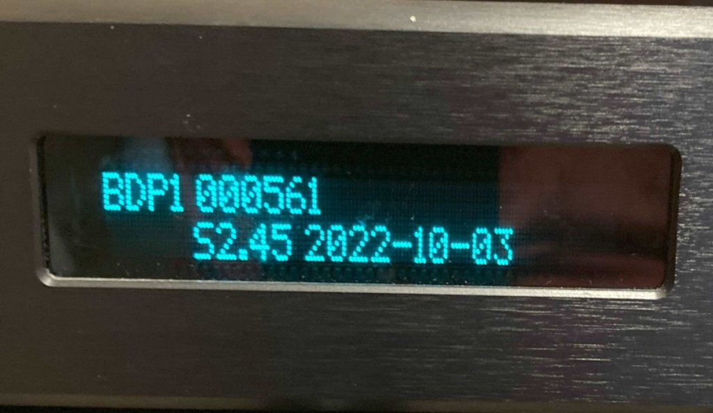

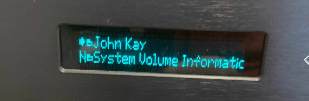

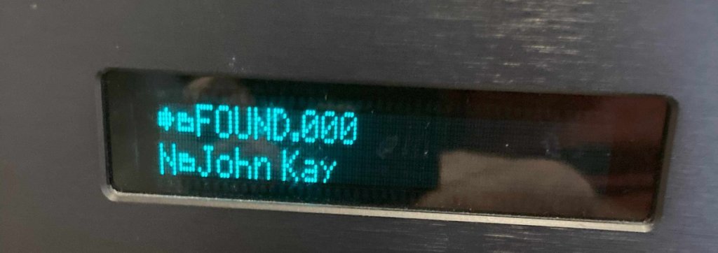

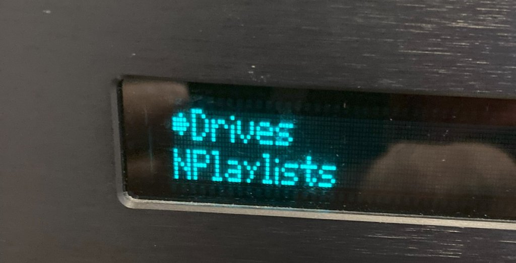

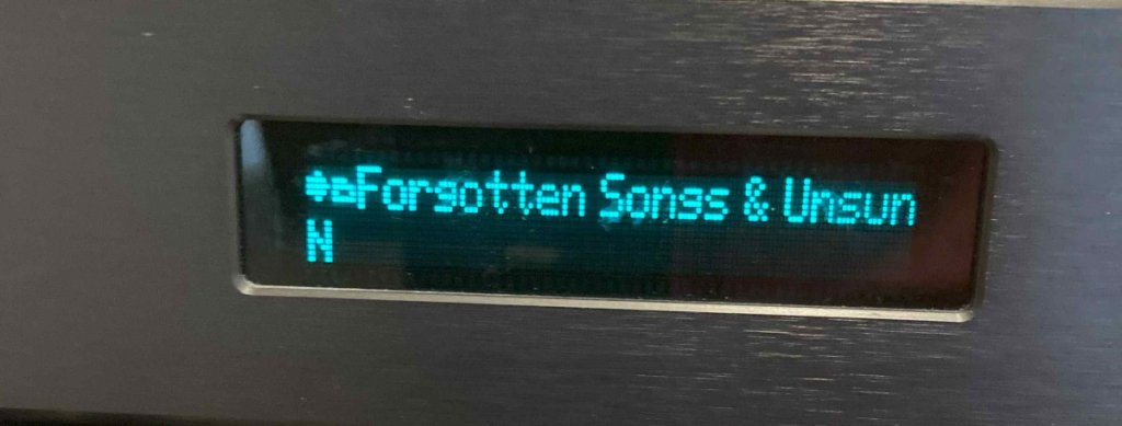

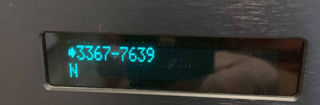

« Reply #1633 on: 12 Oct 2023, 06:42 pm »
Update. BDP-1 still not working.
To recap what I've tried.
Long story.
My, early, BDP-1 sat in its box for a few years. Recently got it out and connected. It updated to S2.45 seamlessly.
I’m on MPD 17.6.
BDA-1 showed 48K and Lock.
Then problems started.
Initially connected a WD 1TB hard drive in the rear port. The BDP-1 saw the drive, but nothing on it.
Put an album on a SanDisk 512GB flash drive and connected to the front.
Saw the drive and the songs, wouldn’t play them; play button wouldn’t work.
Put a song on a SanDisk 512MB flash drive. BDP-1 couldn’t see it.
Gave up for a day.
Went back and then I got the Error 09.
Opened it up, checked connections and they seemed fine. Gave them a push anyway.
Replaced the battery.
Hooked it up again and no Error 09!
Not so fast.
BDP-1 sees the drive, the album and the songs. Still won’t play.
The play button on the BDP-1 doesn’t do anything. The virtual front panel on my iPhone is the same.
Any thoughts?
Here is the menu progression:
James Tanner
  • Posts: 21080
  • The Demo is Everything!
    • http://www.bryston.com
Re: BRYSTON BDP-1/2 FREQUENTLY ASKED QUESTIONS THREAD
« Reply #1634 on: 12 Oct 2023, 07:53 pm »
Please e-mail Adam on this - [email protected]
JfTM
« Reply #1635 on: 18 Oct 2023, 03:26 pm »
Adam got it working again!
Need to reflash the CF card.
Thanks Adam and James
