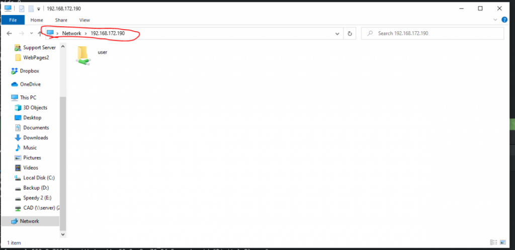

Have you tried connecting to the BDP by specifying the IP address?
\\<bdps ip address>\
Chris
Sorry if I am being dense here.
Yes I can connect to the MM dashboard using my internet browser and the IP address but how do I get from there to copying music?
David

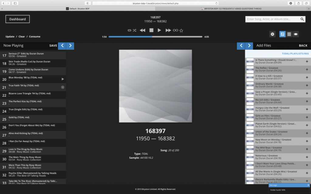

Hi Bryston People,
I don't know why a TIDAL playlist would show song info and art for some artists (Duran Duran/Roxy Music/etc) and nothing for other artists (Blue Monday song...artist not shown).  Plus the song titles are numeric garbage!
I have a BDP-1 with updated firmware S2.44.
Tidal is on lossless.
MPD settings allow for Bryston DB, scraping etc
Reboot the system.
Nothing amiss when I check playlists using tidal app on laptop.
I searched Audio Circle for a similar issue and solution before asking.
Any help would be helpful!
David

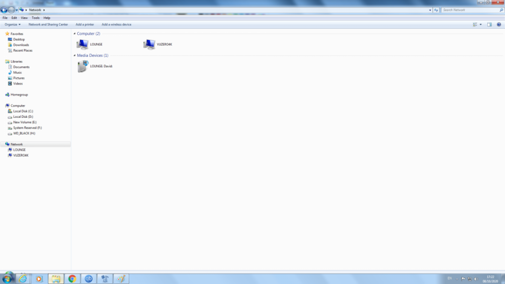

Bridger
  • Posts: 7
Re: BRYSTON BDP-1/2 FREQUENTLY ASKED QUESTIONS THREAD
« Reply #1523 on: 8 Oct 2020, 04:32 pm »
Very sorry but whatever you are trying to get me to do - I cannot get to work
Other devices on my network are available.
If I type the ip address in the top line  - then Internet Explorer is launched and I am at The Dashboard
At a loss as to what I am supposed to be doing
Addendum
I have found that a second Win 7 PC on the network can "see" the BDP 2 in Windows Explorer and so I can copy music from it.
My main PC can see everything except the Bryston.
So go figure !!!
« Last Edit: 9 Oct 2020, 03:41 pm by Bridger »
Silverbullet
  • Posts: 40
« Reply #1524 on: 9 Oct 2020, 09:35 pm »
I know at one stage Microsoft released a version of Windows 10 that couldn’t see old Samba based connections and you had to get in and change some settings in Windows. I can’t remember the details and you say you’re using Windows 7 but maybe there is a related update that caused this in Windows 7 as well.
I’m sure this is a Microsoft issue.

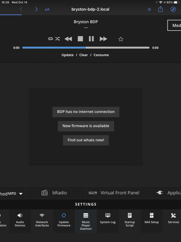

ebogda01
  • Posts: 26
« Reply #1525 on: 14 Oct 2020, 01:37 pm »
Have you tried to reset rather then restart the network settings or perform a factory reset?
Chris
I did now, but I’d required some fast typing before the BDP disappears from the web interface
It stood some time with the U symbol on (I assume it did reset to factory settings) after that the symbol changes to full square/dot and the interface is as on the picture. It’s not responding to any actions through the web interface, but responds just fine to its own onboard controls and plays music just fine
I can still see it as wired client through the router interface showing IP and MAC
Can I try anything else? Thank you!

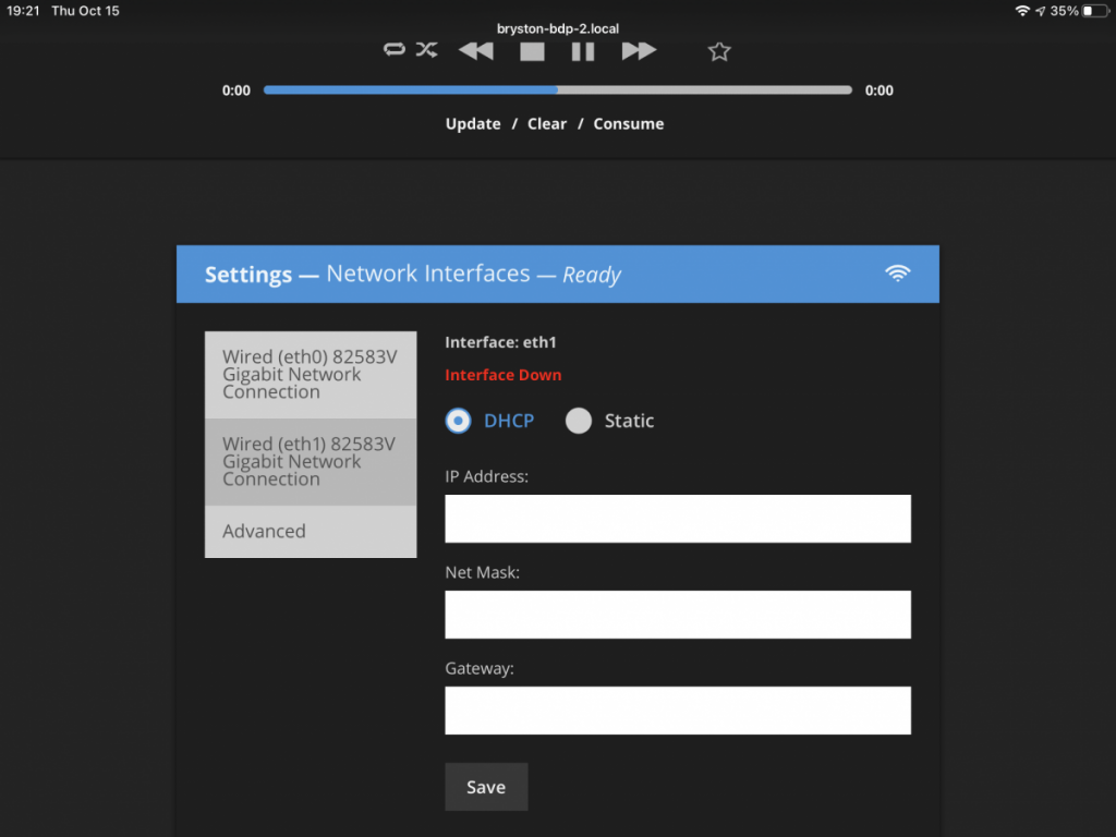

ebogda01
  • Posts: 26
« Reply #1526 on: 15 Oct 2020, 04:24 pm »
Chris
May be this is the indication of a problem?
But it’s still unclear why the player does become visible/discoverable albeit for a very short time

« Reply #1528 on: 16 Oct 2020, 05:15 pm »
The BDP-2 has two network connections, so it's normal that one of them would be down.
Using the down arrow button on the from of the unit you can check the status of the network interfaces and should tell you if both interfaces are down or if one if the interfaces is still reporting an IP address.
Chris

ebogda01
  • Posts: 26
« Reply #1532 on: 16 Oct 2020, 09:35 pm »
Chris
Both of them are showing as “down”
Also when I scroll with the down button both eth0 and eth1 show “offline”

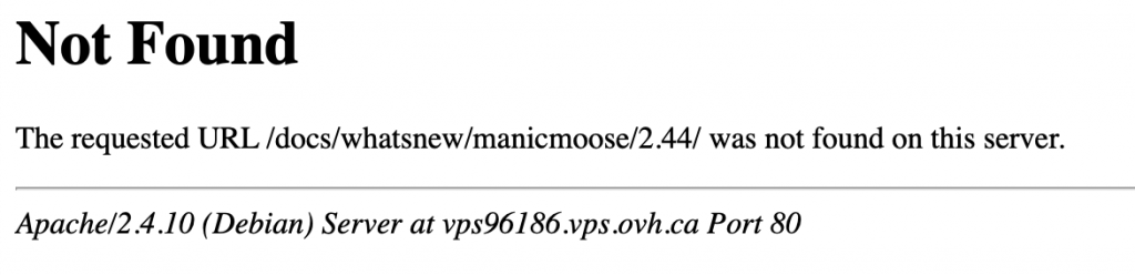

Hey Chris,
Ltns...
sorry if this has been answered before, but I am getting back to investigating my BDP1 (or do I need a BDP3...?) and see this
when I click on the
Code: [Select]
Find out whats new? in the frontend which links to http://vps96186.vps.ovh.ca/docs/whatsnew/manicmoose/2.44/
just a minor glitch, but, well, its on the front page ;-)
