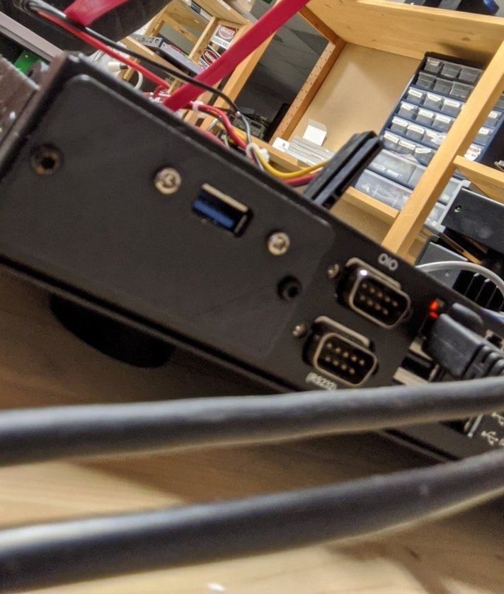

« Reply #1504 on: 18 Aug 2020, 01:29 pm »
Hi Chris!
I have a few questions regarding my BDP-2 player.
1. What is the model number of the button-type backup battery on the motherboard?
2. Can I purchase a spare motherboard and the front panel PCB which includes the display and the button arrangement and how much do they cost?
3. Are the parts under count (2) user-replaceable?
4. When you look at the BDP-2 from the rear, there is a provision on the far left side that's covered with a metal rectangular piece held by two screws, presumably for additional USB ports. Is this an option then and how would these additional USB ports be connected to the motherboard inside the BDP-2?
5. Can the part under count (4) be installed by the user and how much does the part cost?
6. What is the maximum capacity for the internal disk drive? Can I use both conventional HDD and SSD?
Thank you for your time!
Antun

« Reply #1505 on: 18 Aug 2020, 06:26 pm »
1) Cell battery should be CR2032. It is on the BDP-1 at least.

« Reply #1506 on: 20 Aug 2020, 03:08 pm »
Hi Chris!
Antun
The battery should be a CR2032, but it should also be etched into the battery itself.  There really isn't anything stopping any one from replacing there mainboard, there's no soldering involved and cables connected to and from the board are removable.
As far as the cost goes you'll need to email us, it won't be cheap though as those boards where custom made for us and make up roughly 30% of the original cost of the unit.
http://old.bryston.com/pages/contact.html
i wouldn't install anything larger then 2TB in a BDP-2, larger drives may work but there could be boot compatibility issues.
Chris

Chris
Thanks Chris!
OK, I will send you guys an email about the pricing.
Can you please tell me about the provision on the rear paenl? Is it a usable expansion port for USB or some othr type of a connection?
Antun

Re: BRYSTON BDP-1/2 FREQUENTLY ASKED QUESTIONS THREAD
« Reply #1509 on: 21 Aug 2020, 02:20 pm »
Thanks Chris!
Antun
We were going to release a USB 3.0 option once the software was updated to take advantage of it, but then we never released the upgrade kit.  Then years later someone asked us about it and because the BDP-3 uses a USB 3.0 board that's compatible with the BDP-2 I put together a upgrade kit, passed the info to management and then it never went anywhere.  If your interested you could try ordering one, but it could prove difficult and confusing, but apparently its worked before and lead to Bryston offering dress panels in both black and silver and not just black.
Chris
