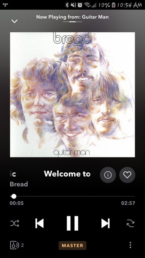

Hey Guys...
Curious as if your able to stream "Master" quality music on tidal through your BDP? I understand your login credentials are made on the BDP user settings via web interface for tidal and or Roon and technically you should playback "Master" quality streams on tidal. I noticed that some devices do not support "Master" quality
feedback would be greatly appreciated.
Thanks
A.P.A
I was reading the thread on (Rookie questions about BDP2 and Pi ) and answers my question sated above.
Thanks James for the answer.
