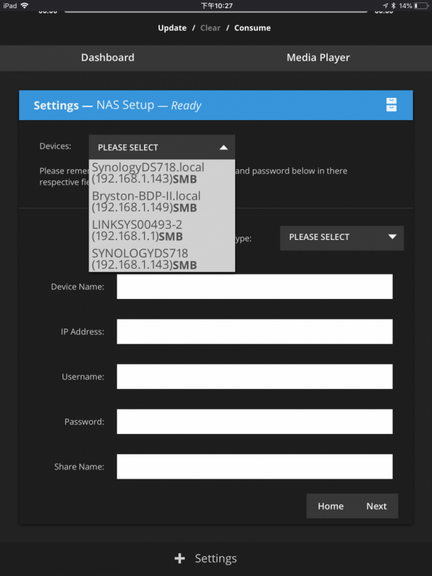

Problem on BDP-II NAS (Synology DS-718+) Setup...
I recently purchased a Synology DS-718+, with HDD (10TB) placed on HDD1, HDD2 kept empty.
The HiRes Files were placed on “music” folder, then have about 20 sub-folders like HDtracks, Opus etc...
The HiRes Audio Files are behind the sub-folders.
When I go to NAS setup page, I find that after entering the correct Username & Password, errors occurred when I press “Next”.
The “Share” folder appears to be “1” instead of “music”, when I continue to press the sub-folder, it appears to be “Incorrect Credentials” & a message somewhat like “permission denies”, the BDP-II stop responds & got stuck on the NAS setup page.
May I know the reasons why & what can I do to make BDP-2 possible to read Synology NAS HiRes files?
Thanks...
PS:
I’m sure that all the setup of DS-718+ are correct. And I’ve successfully connect several NAS to BDP-II   previously
« Last Edit: 20 Apr 2018, 02:06 pm by GoGoDuck »

Are you selecting an the Synologies AFP or SMB file sharing service?
Chris
GoGoDuck
  • Posts: 11
Re: BRYSTON BDP-1/2 FREQUENTLY ASKED QUESTIONS THREAD
« Reply #1358 on: 20 Apr 2018, 02:03 pm »
Hi Chris,
SMB...
Devices found which are related to Synology NAS is SYNOLOGYDS718.local (SMB/AFP) & SYNOLOGYDS718 (SMB/AFP)
In fact I’ve been tried both...
