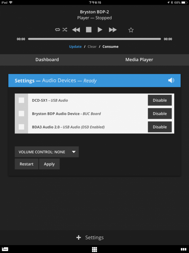

Hi,
I’m using BDP-II with new Bryston IAD,together with BDA-3 & Denon DCD SX-1. However after I’ve updated the latest firmware on the early October, I found the the Denon SX-1 no longer support DSD files played by BDP-2(USB Connection). While the BDA-3 remains normal; on the other hand I’ve tried to connect Denon DCD DX-1 with other DSD Capable Media Players as well as Computer (JRiver), the Denon DCD SX-1 remains normal with DSD Playback.
That’s why I came to the conclusion that there is something wrong with the latest BDP-2 firmware.
What can I do? Or is there a newer BDP-2 firmware to solve this issue?
Please let me know...
Thanks for your concerns...
Peter Ip

You don't have the checkbox next to your denon checked to indicate that its DSD capable.  Once checked and saved you should see DSD enabled next to it like you do with the bda-3.

Thanks for your fast response and help...
The audio setting has changed for unknown reason, but it works now...
Thanks!

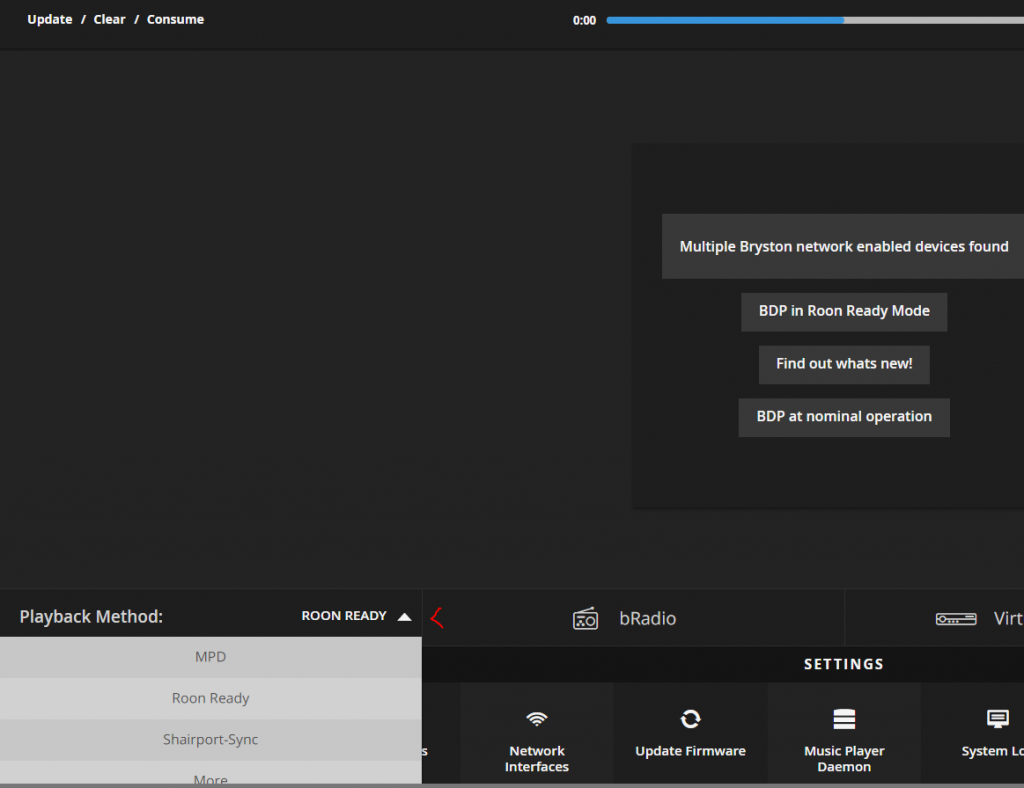

hi chris - is it possible to switch between MPD and Roon (in the BDP1) without going into "Services" to manually toggle?
thanks!
