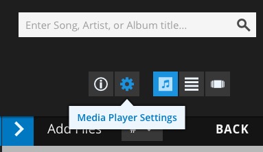

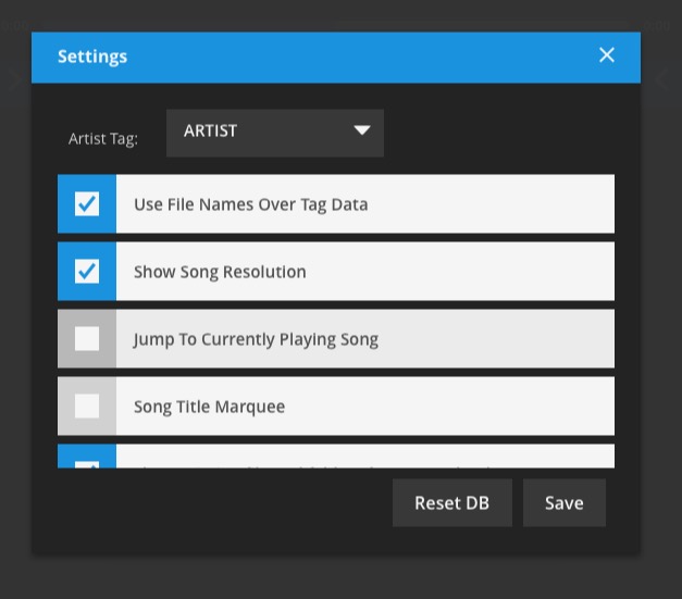

clicking the gear icon of media Player settings:
gives an option to click Reset DB and Save.
Do that, (click Reset DB) restart ((I think the BDP does that automatically, if not click reboot in System), and let the BDP update its library.
Might take awhile, (large library, small memory BDP1) but still, only 1 tb shouldn't take all day ;)
