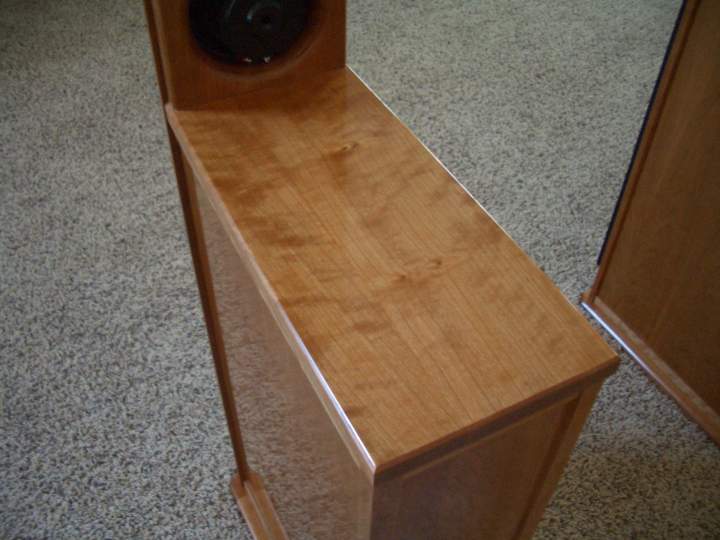

Wet Look or just a glossy finish?
I really liked this General Finish wipe on poly. It takes several coats with sanding inbetween, but the results are beautiful. The wood grain looks deep and rich. It kinda glows depending on the lighting.
http://www.generalfinishes.com/retail-products/oil-base-top-coats/arm-r-seal-urethane-topcoat
Will2
Re: How do I get the "Wet Look"?
« Reply #2 on: 7 Feb 2011, 01:51 am »
That looks great Neil.  What type of sanding is required between coats (hand sanding or can I use an electric sander) and how many coats does it take to get that finish?
NeilT
« Reply #3 on: 7 Feb 2011, 02:09 am »
I used 400 grit sanding pads, all done by hand. Just hit it lightly, after it has a good chance to dry,  knocking down the high spots, and runs if any. Wipe off the dust with rag. Depending on the weather, maybe a couple of coats a day. It will start to build up nicely after about 4 caots, then it is up to you. I lost count on my project. I buffed it out with auto finish for the final look. Others from AC may have better tips.
Have fun and take your time, if you screw up just sand down the mistakes and start over. I used a foam brush and rags. It depends on the size of the surface. The foam may work better with larger areas. Just wiping on the first coat, you will see the wood grain just pop, and it just gets better with each coat.

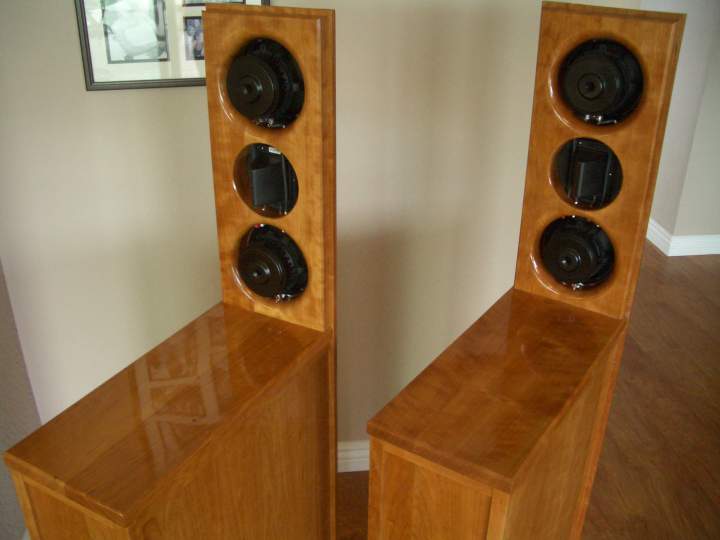

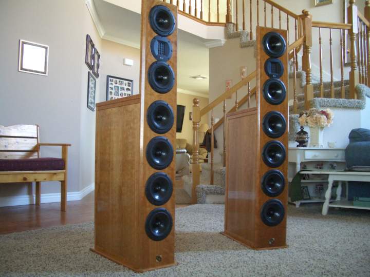

I did much the same as Neil but used the rattle can acrylic.  About 4 heavy coats with a day of dry time in between each one and wet/dry 500 in between coats as well, tack cloth the dust off after sanding and start the next coat until you have built it up to your desired look.  My final coat was let to sit for a few days to get a solid cure and then I did 500 wet, 1000 wet, 1500 wet, 2000 wet, and finally an automotive buffing/polishing/wax...I've done two different veneer types so far and the amount of work varies greatly depending on the wood you are using, some suck it up, others don't.  The biggest enemy is the wood spots that soak it more than others, creating dips in the finsh and/or even bubbles that will dry to little mini volcanoes - you might want to perfect your skill on a seperate piece prior to hitting your speakers.  The best thing is you can always sand it off if you do get drips/runs.  Here are a couple photos of my latest:
Mozambique
Bird's Eye Anigre
Will2
« Reply #7 on: 9 Feb 2011, 06:37 pm »
Thanks Beatcoaster - that's just the type of thing I need.  How thorough did you find you needed to be with the sanding between coats?  Just a light sanding or a thorough go-over?
Beatcoaster
  • Posts: 76
« Reply #8 on: 9 Feb 2011, 06:51 pm »
Early on I was able to keep it light, as the first coats seem to just be soaking into the wood - hand sanding accomplished this with a foam block (Harbor Freight = cheap foam sanding blocks, not $4.00/ea at HD/Lowes).  As it progressed the acrylic slowly started to build up and fill in the wood grain with each coat and the sanding seemed to get more intensive.  Even on my later coats there were still areas that were clearly lower than others and I felt like all I was doing was sanding off dollars of acrylic each time, but it just needed to be built up and remain flat.  Once you have some good build up, 4 or 5 coats I would expect, hit it with the various sandpapers and let it sit for a week or more to cure 100%.  I learned this the hard way as I had only let my final coat sit for a couple days and the wool pad I was using to do my initial buff scratched it all to hell and I had to redo an entire side of one speaker.  I thought the wool pad has something on it, but the acrylic was still just that soft.  The orbital buffer with wool/foam pads and a good polishing compound is a must at the end or your arm will be toast, and it will bring a smile to your face when you see the mirror just start appearing!!
