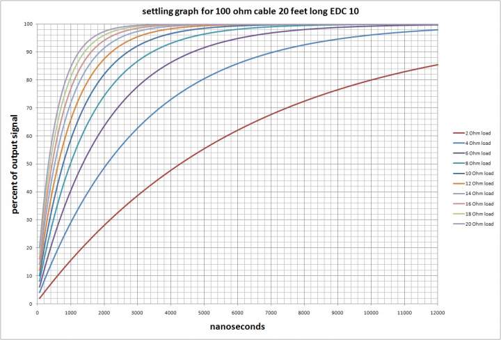

hmmm..I was hoping to have it pop up as a pic, not a link..oh well.
wakibaki.
If you really wanna flex your thinking about t-lines, try an analysis of a speaker cable driving a speaker load.  Here's a graph.  If you're interested, we could start a new thread.
http://www.audiocircle.com/image.php?id=38430
edit:  as it is, I've been considering a collaboration with some guys on actual hardware and testing to validate this..
Cheers, John
