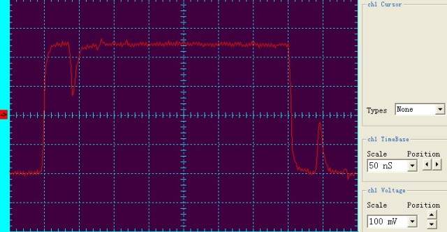

Let's see how far I can get, without any sophomoric interruptions, ok?
There have been a lot of 'scope shots, and other stuff, proclaiming what attenuators can and can not do. Mainly on the DIY sites. Part of the problem is while they used real-world products, it is not much a of stretch to say it may not be the best source, to use for this.
Here is what attenuators do:
1.) They attenuate the incident signal, by the amount of the pad.
2.) They attenuate the first reflection, by twice the amount of the pad. This is because this reflection has to make 2 round trips, so it gets hit twice.
3.) Some folks think it will fix ringing, overshoot, and other design problems. It will help some, but counting on them to be a magic bullet........well, maybe you ought to address those problems, without worrying about pads. It can do things, to make a crappy output look better, but it makes more sense to fix the problem, rather than hope a pad will fix it.
OK, enough sarcasm. On to the pics.
First, we need to know the set-up. Output is some SPDIF gizmo, with a fast rise time. (Under 1 nSec. Important.) Output goes to a Tek 475 'scope, through the shortest possible means, which is a 75R BNC female-female. The 'scope has a Tee, and yes, it is 50R, with one end going to the female BNC, and the far end going to a cable. The 'scope has 20 pF or so, of capacitance, so it will have a slight effect on the waveform. Let's ignore that. It really doesn't make enough of a difference to get excited over. At least not for this experiment.
The cable is a 5 m or so cable. For the first picture, the far end is unterminated. After the signal rises, at about the 1.5 div mark, it goes up, about the same amount as the incident wave. What happens is the reflection coefficient is +1 (because it is an open circuit), so you add +1 to the original 1, to get 2. Yes, that may sound simplistic, but that is how it works.
At around one more division, there is a slight negative spike. This is the first reflection! As it hits the source, there is a negative spike, as the reflection is terminated. Part of it bounces back, and you can see that as slight positive spike. This is the second reflection. Eventually, it is absorbed, and it dies out.
This is what it looks like:
OK........everyone have some idea what reflections look like? If not, let me know what needs to be clarified. I have been doing this for around 40 years, so it is routine.
Here is what happens when you terminate the far end:
(The vertical scale for the unterminated shots are all 1/2 vertical scale. This is so the whole waveform can fit on the screen.)
"Why is there a glitch?"
The glitch shows the cable is not really 75R. It is 2 ohms or so higher. OK, before someone freaks out, you have to understand something about coax cables. Almost all of them are spec'ed to be +/- 3 ohms. Not just at the end, but how much it can vary, along its length. This is within spec. Good cables are spec'ed at +/- 1.5 ohms, but it comes at a price. You are not likely to run across many. There are precision ones, spec'ed for +/- 0.75 ohms. They are only found in test labs, so don't ask where you can get one.
But, you will notice there is no first reflection. Since the load almost perfectly matches the source, and the cable, it is absorbed. At least to the point where what little makes it back to the source, is non-existent.
"Yeah, but what happens when you hook it up to a real DAC?"
Glad you asked!
OK, here is one. Contrary to what some know-it-alls will say, you need more than a ohmmeter to get the impedance right.
Yes, it has a RCA. Just like most of yours. What happens, once it is inside? Well, it isn't mine, so I am not going to take it apart, and nit-pick the guts. Let's just agree it is a lot like what you have.
Here it is...............!
Still like RCA jacks?
"Why is there a small step down, right before that big spike? What caused that?"
I inserted an variable attenuator, in the line. Right before the DAC. Had to run a very short cable, from the attenuator, to the DAC. That is the short step down. (Yes, its impedance is lower than the main cable. Closer to 75R, maybe even a tad lower. I am doing this at the house, so I don't have access to the TDR, to give a 100% accurate answer. But, I think it helps show the effect cables and stuff have.)
OK, since there is an attenuator, and what I'm sure you guys are dying to know.....................
2 dB:
4 dB:
6 dB:
8 dB:
10 dB:
15 dB:
20 dB:
Gee, when we get to 20 dB, you don't see the DAC! All you see is the glitch, caused by the short cable.
"My DAC won't lock, with that much attenuation."
Not the point, of the exercise. The point is to show what attenuators do. Not whether or not it will work in your system.
"Well.............well.............we don't want to use one of those stupid 15' cables. Why don't you show us something we use?"
Fair enough. I think since we have an idea what reflections look like, and since I can not hook up the DAC, with only a 1 m cable, I am just going to show open and terminated conditions.
1 m, terminated:
1 m, open:
(Remember, 1/2 scale)
Yuk, eh? Look at all that nasty ringing, that wasn't there, with the long cable.
Let's magnify the horizontal scale, 10x, just to get a close look:
The terminated condition:
And, the unterminated (open) condition:
Not something you want to come home to.........
Ok, here is the key, to this:
We went from a 5 m cable, one that is so long, almost no one wants to use it, to one that is 1 m, which is what everyone wants to use.
And.............
This is with a very fast source. It has a rise time, around 0.8 pSec. The problem is...........
A lot of you guys have transports/sources that are closer to 3-4 pSec. And what is the significance of that?
That first reflection...............guess what.............guess where it ends up.............yeah, somewhere in the transition portion of the waveform.
I will let you guys decide how attenuators will (or will not) help, with really short cables, on typical HC logic sources.
"Can we ask you one more question? Where should we stick the attenuator?"
Good question. I would stick it, on the end that has the poorest return loss. And since no one knows that (except dorks, like me!), that isn't much help.
Let's put it this way: you now know what it does, when you stick it on the DAC end. Maybe tomorrow, I will do the same tests, at the source. The results may be skewed, as the source has a very low reflection coefficient. So, if someone asks nice, and/or I find the time, I will run a short version.
Hope this clarifies some of the myths and other confusion.

Oh, forgot to add one minor detail...........
The termination was connected through a 50R barrel. I did this, on purpose, so that it would be easier to see where the termination is. It would have been hard to see, with a 75R barrel.

What time base are we seeing?  Or what is the frequency of the square wave?

« Reply #3 on: 20 Jan 2011, 02:58 pm »
It is a 44 kHz SPDIF signal. I forget what setting, but it was near the end of the scope's range. Probably 0.02, or 0.05 uS. Probably the latter.

Theoretical max. speed is 300.000 km/S or 0.3m/nS (nano-Second). Inside cable signal is slowed down.
Velocity factor for 75R coax is 0.67 for RG-59. Speed of signal inside coax cable is 0.3 m/S * 0.67 = 0.201 m/nS or 4.975 nS for 1 meter.
If lenght of the cable used is 5 m, then reflection must travel through cable twice, this is 10 m.
10 m * 4.975 nS = 49.75 nS. Reflection on the pic is visible 1 divider after signal launch, then divider used must be 50 nS or 0.05us.

OK, looked at the 'scope settings. It is 0.05 uSec. Did not check to see how well it is calibrated. Not sure that is germane, but I am sure someone will ask.

yes, it should be 0.05 uS or 50 nS. I'm using 4m RG-59 for measurement and got reflections ~ 40 nS later. Capacitive termination.

Thanks for pointing out the typos. 0.8 nSec. (It was late at night.)
As for the RCA......
Yes, it should show a negative going spike, but as you have deduced, whatever is after it is causing that spike. My guess is that this unit has the SPDIF  transformer that everyone (well, almost everyone) thinks they must use. Guess I should take the lid off, and verify.
(Stuck at home today............ice everywhere. So, something to do.)
The small downward step is indeed the cable. Its impedance is a bit less than the other piece.
Pat
