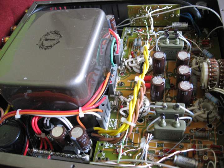

Inside Onix Melody SP3 Tube Amp
« on: 9 Jan 2011, 04:56 am »
I bought a used SP3. My very first tube amp purchase, having sworn to myself that I won't try to build anything for at least 6 months (ha ha, there's a SimpleSE pcb laughing at me in a drawer). I got it tuesday so as you can see it took me 4 whole days before I opened it up. No mean feat. Mostly because tubes are new to me. Anyway, I wanted to take a look inside because while researching the Onix I noticed that there were several variations since the MKII debut in 2004: the 6 moons, Audioholics, and current amp (sold overseas) have their differences and it seems to my eye that newer iterations appear more 'mass-market'. No P2P wiring of any kind, straight pcb. Maybe it's just increased efficiency... maybe not. I read something about the later version being originally intended for another design. In any case, I was happy to open this guy up and see that it's the earlier version. Chinese(?) PIO caps, silver or silver plated copper wiring, stepped attenuator with Dale resistors. Pretty darn nice! I'll probably just do some basic mods if possible - space is a little tight. Replace some of PS caps and maybe add a film cap if I can fit it. Replace the fuses (sorry if that offends, but they gotta go. Acme's are only $10 anyway.). Debating on the PIO caps. That's the real potential money pit. May just leave them. The real aim is to bypass the attenuator altogether so I can use the lightspeed. We'll see if that happens. At any rate, certainly seems well worth the money paid. Beautiful chassis to boot. Open to constructive thoughts and suggestions.
« Last Edit: 9 Jan 2011, 08:31 pm by wushuliu »

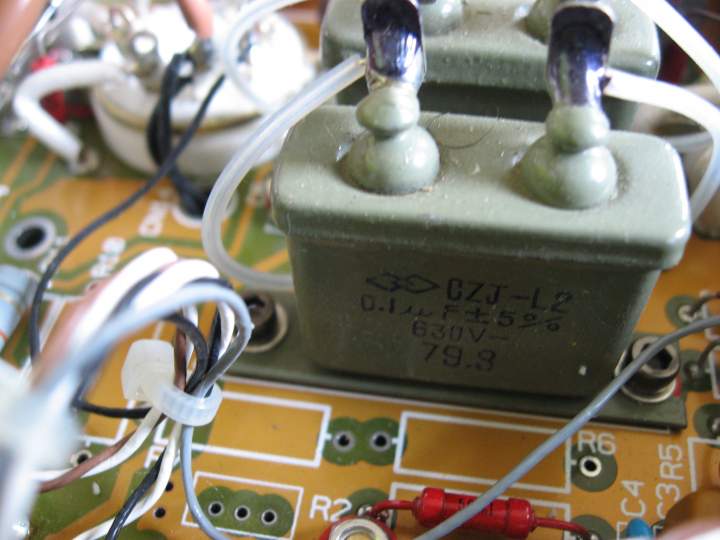

This got me curious, since I have the last Onix version sold by by AV123 the SP8/3, which was originally supposed to be a rebranded Melody SP7 (EL34 based)  http://www.usatubeaudio.com/melody-sp7.php  But when the actual amps arrived for sale at AV123 they ended up being another variant of the Melody SP3, from a practical stand point the main difference is the base bias is .4V rather than 1.15V. After opening the case, the construction looks very similar to your photos.
Cool. So coupling caps range from .1uf to .47uf., minimum of 250v. Good to know. Thanks for the tube info Jim!

« Reply #7 on: 18 Jan 2011, 08:50 pm »
Ok. so far I have:
Replaced coupling caps with Ampohm Aluminum PIO
Replaced Aux jacks w/ Vampire CM1FB or whatever, the copper body one
Replaced signal wire with Neotech UPOCC teflon
Replaced all fuses w/ Acme Audio
Bypassed the attenuator, replaced it with Optical Volume Control (lightspeed)
12BH7A tubes for driver and preamp stages
Valve Art 350B Power Tubes
There was some drama when some unseen solder shorted a wire beneath the board, causing redplating and bias issues, but that's been sorted. I also used some Jantzen Superior caps for coupling briefly and they also came off better than the stock caps to
my ears. The Ampohms have similar performance but do add that extra something as far as texture.
The amp now sounds outstanding. Lots of settling in to do yet with the tubes and caps, but I am very happy. Also some shielding needed for signal wire. Pics later. 8)

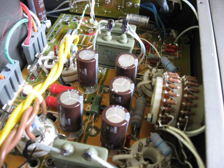

theres quite a few of these out in the wild with some problems, since av123 sold a bunch of "for parts only" units.
i have gone through mine a bit, and was wondering if your input wiring goes through the bias board, and through those relays on there. if so did you replace the wiring before and after the relay,or did you just bypass the relay all together and make it a 1 input unit?
also, did your attenuator bypass create a large amount of noise in the output? i noticed with mine at full vol, its rather noisy even with nothing plugged in.
also, on my previous sp3, i did sonicap platinum bypass on the .47's and .1 platinums on the coupling caps for the preamp tubes :) if i can find them ill post a few pics
The short was on me, though the inconvenient wire placement did not help. I replaced the wiring before and after. There's some low level noise, not much but I'm hoping shielding the new wires will help with that. Are you using low gain tubes for the pre section?

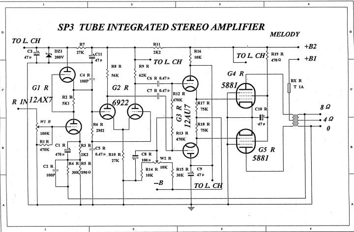

wushuliu- How did you know what values to change to?? Did you have a schematic of your amp or was it just open'er up and look around?
wushuliu
  • Posts: 3764
Re: Inside Onix Melody SP3 Tube Amp
« Reply #12 on: 18 Jan 2011, 11:00 pm »
Both in the end. The stock amp uses smaller value than shown in the schematic (which is somewhat outdated), and since the smaller ampohms are cheaper, went with that. I also used the larger .47uf indicated in the schematic with no issue.
i was using 5751's i believe and amprex 6922's. 350b's as well. i think upgrading the rectifiers might make a huge improvement in the sound quality, but they were relatively difficult to get to because of the terminal strip and caps.  i dont think shelded wires will get rid of that extra background noise on this amp, but let me know if it does.
