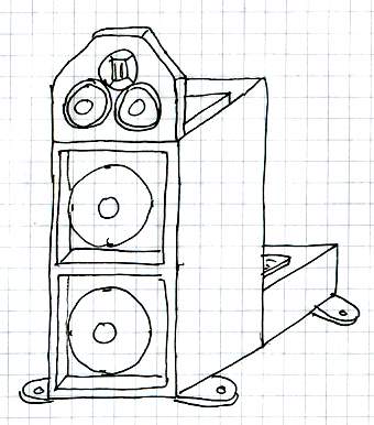

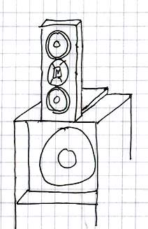

I have a third pair of GR Research unit, which is a V2 (Oversize Ferrari red/see earlier post for a picture) but with only the sub section and I want to use it to experiment with the N3 kit I just bought.
I want to use the N3 kit for the mid and high frequencies and put it on top of the V2 which will take care of the bass.
Like this.
AC 02
If I put it like this,
AC 01
it will look a little strange and it’s out of the question to modify my V2 as per Danny’s suggestion.
There is nothing wrong with my super wide and not very slim V2. Making it narrower, to me will not make it sound any better and only means that I have to build a new pair of V2.
I want a N3 open baffle, not bass reflex or sealed box.
I want to have the N3 to work like the top section of the OB-5/7.
There are two good reasons why I want to use almost exclusively enclosure-less configuration.
No enclosure coloration and ease of construction.
I want to go that way with all my projects and the only exception will be my entry level N3 transmission like enclosure.

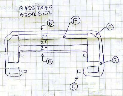

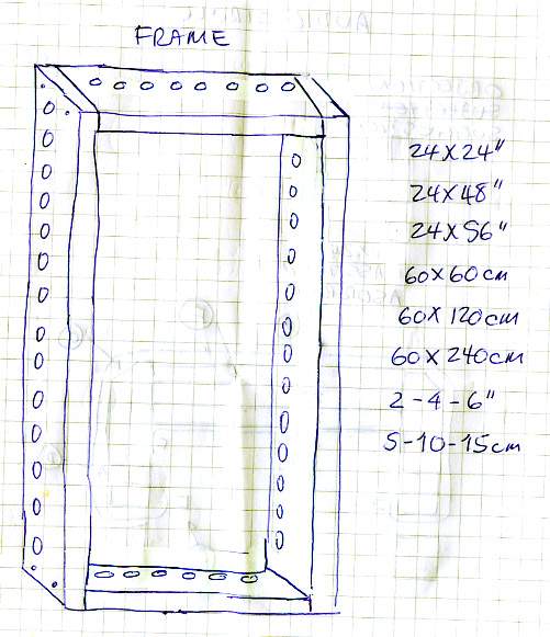

Hi all Audio Circle members.
Two more products Audio 13 (My soon to be audio business) would like to offer to the Vietnamese audiophiles are absorbers and bass traps.
I did lots of reading on that subject on the Internet and found out that each manufacturer have their own way of building those units.
You can see below my conclusions (Hand sketches) and as usual, if you don’t agree, let me know, if you want to add something, go ahead and if you agree, well, let me also know…
I want to use the Owen Corning 703 fiberglass boards that most of the people use or maybe an equivalent of same density and thickness, but much cheaper in price.
I want to use burlap on front and in the back a thinner, or should I say: Cheaper version.
For me, one point that seems to be important; is that you should leave spacing in the back between the fiberglass boards and the wall so that the fiberglass can vibrate, I also want to add some breading holes all around the frame.
A : Back support thin burlap.
     Located about half way on the thickness of the frame.
B : Front burlap that will wrap around the frame and will
     be held in place by staples, lots of them.
C : Angled outside frame edges, to make the frame look nicer.
D : Breading holes all around the frame, they will be covered
      with burlap, but there will be some many, that the back frame
      will still be able to let some air escape.
E : Staples, many, many…
F : 703 or equivalent fiberglass boards, one, two or even three
     (For bass traps) two inches thick each.
Before I offer those items to the audiophiles, I will try them myself in my acoustically treated listening room and most important, I will try to find one or several suppliers that can supply me with the raw material at good prices.
I would like to offer my units at prices below what is available on the market; I think it should not be difficult, since most of what I saw was… Well, let’s say, not in my price range or not within my budget and not within the Vietnamese audiophile’s budget.
I just hope that once I have introduced those products in Vietnam, I will not be copied; well… I know they will copy me, but it will be difficult for them to get the right kind of fiberglass.
Guy 13

« Reply #98 on: 1 Mar 2011, 10:17 pm »
nternet googled basstraps.
I don't see anything wrong with this.  The legwork has already been done on an engineering standpoint.  All you have to do is apply them to your design.  The internet is amazing.
Good luck Guy 13  :thumb:
