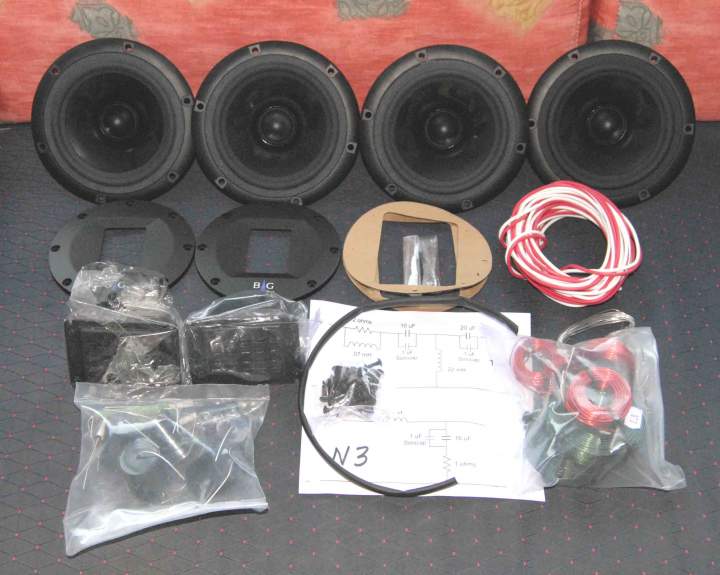

Today I got my GR Research - N3 kit, just in time for the Vietnamese Lunar New Year. (To me it’s like a Christmas gift…)
Danny’s kit was brought to me from Seattle by a relative of my wife that came to Vietnam to visit her family for the Vietnamese Lunar New Year.
The N3 kit was well packed, nothing was damaged and nothing was missing. Thanks Danny.

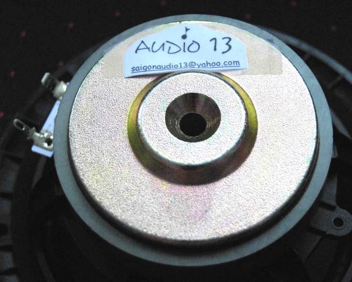

AC10
The only thing that tarnish a little the near perfect score are the small stickers on 5 of the 6 coils that fell off, but looking at the drawing included with the kit, I could easily identify which was which.
I’ve noticed that the driver’s baskets are made of…
Well, look like plastic, but I’m sure it’s better than some cheap plastic. Danny would never sell us cheap stuff !
AC11
Other than that, the little drivers look quite small, but nice. According to what I read on Audio Circle, they should sound as good as they look.
I don’t like the solid wire that Danny always supply with his kits, but I will use it, because Danny said it’s good and when Danny says something, it’s like God’s word. (LOL)

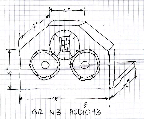

AC12 – AC13
My set up will look like this. Any comments are welcome.

Guy I hope you realize that you can't take a kit and change the layout of the drivers without re-working the entire network.  The exact spacing of the original driver layout has been "programed" into the network to get the accoustic centers lined up.  Not to mention that the floor bounce and ceiling bounce are also taken into account in the design of the network... Many worries for Audio 13 if this is what you have in mind.
Hi HT cOz and all Audio Circle members.
I realize that I can not change some things or everything around as I wish, if I want to get the same performances as it was originally design for.
I have been around on this planet for 63 years to realize that.
Thanks for your advice.
In my alternative version, I am trying to keep all drivers as close as possible to each others.
Floor and ceiling bounce are taking into account at the manufacturer listening room, however, each customer as a different acoustic from his listening room.
Don’t worry about Audio 13 and me, if it does not give the performances as per the original specs, I can always put the drivers in the original N3 TL enclosures.
My design or should I write, my version/alternative of the original N3 kit is a little the same as the OB7 but the drivers are in a pyramidal shape and the woofers are the ones from my V2.

Guy,
Do, and design, what makes you happy.  It's your money and time.  If you seriously do want to design speakers, you might try to invest in a measuring system.  They aren't cheap, but if you are thinking about doing this as a business, it would be a logical next step.
By the way, one of my high schools students put together a design similar to your sketch.  I really didn't think it had a prayer, but the FR curve actually measured rather mediocre, much better than I thought it would.
Scott

Hi Scott and all Audio Circle members.
Thanks for telling me to do and design what ever makes me happy, that was my intention, because in my life (In Vietnam), there are too many things that makes me unhappy ! (LOL)
Then, why stay in Vietnam you might ask?
Well, it’s like I have very little choice.
(I will spare you the details.)
It’s my money and my time you say.
You are right on that.
I don’t want to design speakers; I only want to try different things/approaches to see what I will offer to the Audio 13 customers and what I will offer the Audio 13 customers, is what I would buy myself.
Don’t forget that my future business will be at first a hobby and I intend to have a year or two of trial period to see how it goes.
I still have my wife business to survive if Audio 13 doesn’t generate enough money.
I will invest a minimal amount of money in measuring instruments, I’ve managed to get the exclusive representation for Bellari/Rolls audio products and I also have access to other audio lines.
I don’t have yet a precise opening date for Audio 13;
I still want to try a few other things to see which products will be on my Audio 13 list of offerings.
I am not looking at making millions with this new Audio 13 business, if I break even, I will be happy.

FYI, this configuration will require a new crossover design:
For instance, the crossover for the upper section of the OB-5 and OB-7 are completely different than the crossover for an N3. The open baffle completely changes the response.
Plus in the network of the OB-5 and OB-7 (on the mids) there is a high pass network that pulls the lows off of the mids and not keeps them from receiving low frequency signals. Without that there they would bottom out real easy.
Parts count for the woofer circuit on the N3 is 3. Parts count for the mid circuit in the OB-5 and OB-7 is 8.
Hi Danny and all Audio Circle members.
What parts do you recommend I replace in the crossover and what's the cost?
It's when I read something like what you wrote, that I want to go with a full range driver w/o crossover...

Guy,
If you are wanting to use the drivers in an N3 for an open baffle center channel Danny has another speaker that would more closely meet your needs from a crossover standpoint.  Danny designed a speaker called the OB5 that is open baffle and uses the same drivers as the N3.  Here is the response in an older thread to someone wanting to build an OB center using these drivers:
I see the need for the center as well. If watching a movie or TV, the center will anchor the sound to the center regardless of seating position.
There are several ways to go and match the sound of the OB-5's.
First off you can rotate an OB-5 onto its side and move the woofers to a configuration that puts one on each end. You then rotate the tweeter 90 degrees as well. You can do this with no crossover changes too. Since the lower woofers are only covering from 200Hz and down, moving them has little effect.
Since the tweeter is only 2.125" tall it does not have a very limited vertical dispersion so beaming in the vertical range is not an issue. It has great vertical dispersion.
Laying the OB-5 on its side will limit the horizontal coverage area due to the center to center spacing distances of the mid-woofers. If you sit within 20 degrees off axis each way then you are home free. If you sit further off axis than that you will begin to notice a slight dip in the 900 to 1000Hz range.
For what you are trying to do you would only need the MTM section of the OB5 (which you have in the N3 drivers), the crossover components for the OB5 should do what you want assuming you are wanting to cross over to the V2 woofers around 200 Hz.
edit: I seem to recall that the N3 uses a "Deep Cup" Neo3PDR (planer tweeter), this may or may not change the crossover requirements of the OB5 MTM to work properly, Danny would have to answer that one.
Best,
Ed
Danny Richie
Re: I am back with another project. (Listening room)
« Reply #76 on: 31 Jan 2011, 03:22 pm »
To do what you are looking at and make it work then you need to mount the drivers in an open baffle MTM only 8" wide just like the OB-5 and OB-7.
Then use the OB-5/OB-7 MTM network.
Then use the lower section of the V-2 and be sure to fold the woofers in at the 45 degree angle just like the plans of the V-2 to keep the baffle width down as you will need to match up the 10.5" wide lower section of the V-2 (plus side panels) to the 8" wide upper section of the MTM.
And FYI, that would sound really good!
Here is the frame of a M-130 woofer:
The high strength polymer is stronger than an equivalent stamped steel or cast frame. It also doesn't ring or transmit a resonance to the front baffle like metal frames do. Plus it surface mounts, so the front baffle thickness does not have to be reduced in order to mount it. It's awesome!

From my injection molding experience I know what polymer I'd pick.   :green:
After reading all the above, I've decided to put aside the N3 kit project and wait for some more money to order from Ruben (Out of the woods) a N3 TL flat pack, so I can mount the N3 kit in it.
During my only one week of real vacation I have once a year, I wanted to work on my N3 kit, but thanks to you guys, now I have nothing to do...
I am really getting tired of all that stuff, everything I want to do, turn out to be more complicated than what I want. I hate complicated stuff...
If it gets that complicated every time I buy something from GR Research, I will just cancel my Audio 13 project.
It's not like I need that new business to survive, I still have my wife's business and I can always find another hobby, like photography.
