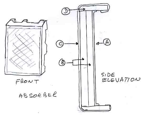

Hi Ed and all Audio Circle members.
Thanks for the suggestion, however, I don't quite understand what you mean. The way I understand it is that the 1/8" plywood would only be some kind of frame ? ? ?
Do you have any pictures or hand sketch ?
You know, as they say: A picture is worth a thousand words...
Thanks.
Thanks.
Guy 13
(ebag4, why not ebag5 or even ebag10 ?)
Guy,
This isn't exactly what I was looking for but it discusses the concept, take a look at this site:
http://www.customaudiodesigns.co.uk/articles/membranes.html
Thanks for the link above, I just finish reading what on their side and again, their approach is different from their competitors.
Who is right ? ? ?
I will do some more reading on other sites and then, decide by myself who's closer to the thruth or who's closer to what makes more sense to me...

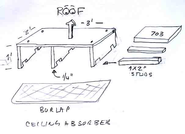

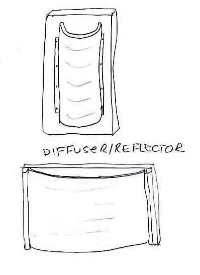

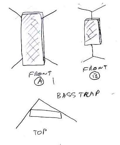

Very shortly, I will post how I want to take care of the acoustic treatment of my future listening room.
For my listening room I am considering the following dimensions :
4 meters wide (Front) X 5 meters wide (Back) X 6.5 meters (Long)
X 2.55 meters (High/front) X 3 meters (High/back).
Still not sure about the slanted roof, I am still wondering if the improvement in sound quality is worth the extra trouble and expense.
I think my future listening room is of a good size and therefore;
I should not have too many problems with the acoustic.
That's what I think according to what I read up to now, but I could be wrong, it won't be the first time or even the last time...
I am thinking of using Bass Traps, diffusers and absorbers in large quantities.
I will make them myself and if I have too many, I will simply sell them to audiophiles.
In Vietnam, bass traps, etc... Are rare commodities...
More later.

Corner bass traps. (AC01A)
I am not 100% sure which is better, the floor to ceiling approach or the partial one (50%).
I am sure that having the bass trap not symmetrical to the corner is good.
I am sure that the front of the bass trap will have 2 to 4” of rigid fiberglass sheets with the back of the panel being empty; however, I am not sure if I should have some fiberglass sheets on back the walls, behind the bass trap.
Experimenting will not cost much; therefore, I will try the two different approaches and hear the difference.
Absorption panel. (AC02)
The same as bass trap, however, the frame will have some slots or openings on all sides, since they will be hanged on the wall,
there will be air spacing between the wall and the fiberglass sheets.
<< A) Back holding thin cotton sheet.
<< B) Two layers of 2” fiberglass rigid sheets.
<< C) Burlap.
<< D) Frame. (Estimated size 24 X 48”.)
         The corners will be rounded for beauty purpose.
Diffusers. (AC01)
They should be called reflector and I don’t think I will need them, mainly because of the size of my listening room and the fact that no walls/ceiling will be parallel. However, if I need some, I have two inexpensive way of doing them and most important, I can get here in Vietnam the raw material to build them.
Ceiling absorption panels. (AC03)
This contraption is my idea and the design is based on what I saw on the Internet, it’s similar to an unfinished basement ceiling with the 10X4 beams. Again, easy to build, several panels can be screwed to the ceiling.
