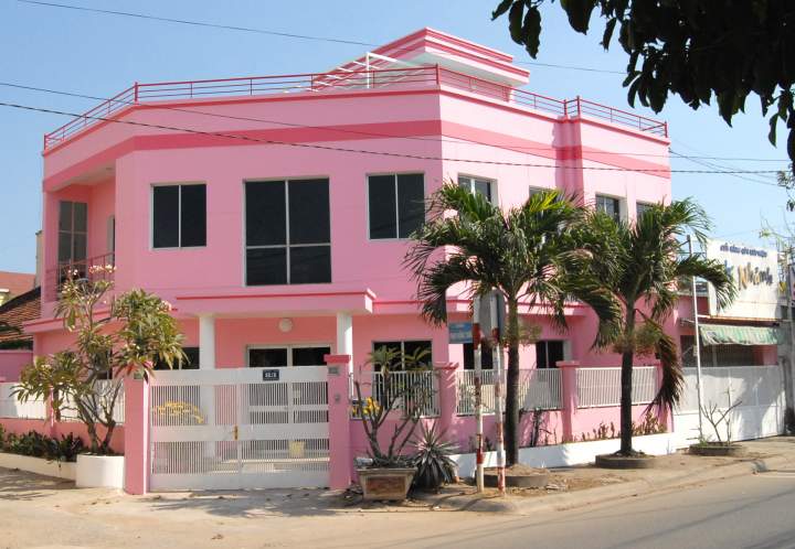

When I got my first house built here in Vietnam, the one below...
I took three months of every day, every minute of supervision.
Now that I have the experience, it will be a little easier, but this new house I want to built, is a much bigger project, I will need to invest more of my time.
I made the architec redo the preliminary blue prints three time and I am sure the final blue prints will need to be corrected, I have to stay on top of this project.

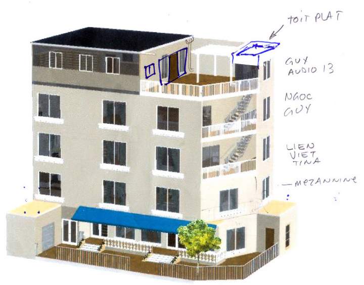

The access to my listening room (and office) will be done via large stairs (4 feet wide) and the doors will be 36 inches wide.
It’s not the first house that I am building; this new project will be my house # 5.

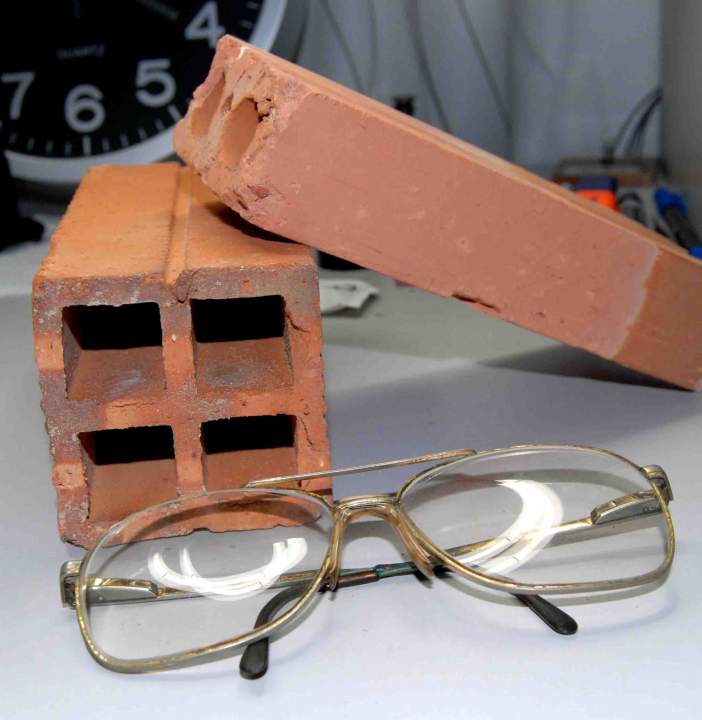

As for the stucco suggestion, the idea is good and I am sure it’s very efficient at diffusing sound waves, but I hate the look of stucco, it reminds me of the Spanish style and I sure don’t like the Spanish style, but thank anyway for the suggestion.
For the adobe, according to the dictionary, it’s some old style bricks; that might be something I might consider.
It’s easy to find here in Vietnam and not too expensive.
I came up with this idea, not sure if it makes sense.
If they are installed at different depth and painted a nice color, it might even look good on top of being efficient at diffusing the sound with the holes in the bricks.
The floor will be made of 12” armored concrete with ceramic tiles on it; however, I will have a thick Asian carpet with a good under carpet and it will cover 75% of the floor area.
The bamboo is not the termites favorite dish, however they do eat it, but if it’s painted with a clear varnish, it will give them some stomach hake, but bamboo will make my listening room look like a resort on the sea side. Again, thanks for the idea.

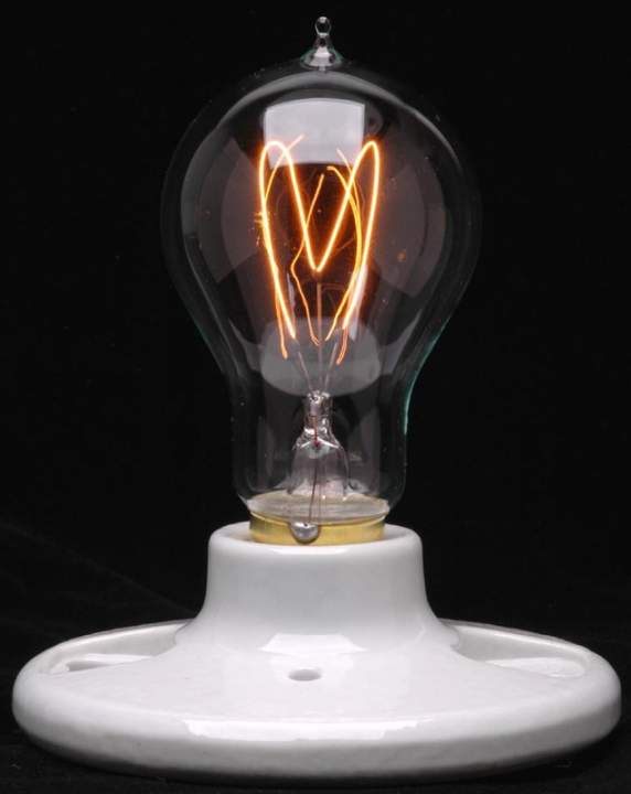

The lighting will be the new energy saving pig tail bulbs with indirect lighting, however they will be turned off when the audition will begin and the incandescent bulbs will be turn on only for ambiance lightning, they will look like this one.
Purchased from Tube Depot for round 10 USD.

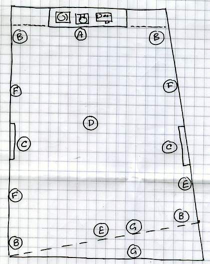

<< Front wall: (The wall behind the speakers)
    Diffusion right?
    How about, shelves with all kind of stuff like CD, LPs, books,
    Vase, and audio stuff of course…
<< Back wall: (The wall behind the listening chair.)
    Diffusion or absorption? (Not sure)
<< Side walls: Parallel or not? Either ways, it’s easy to build.
<< Ceiling: slanted or straight?
   (That’s my biggest problem or decision.)
On my next post I might include a hand sketch on how I see my listening room. A hand sketch made with a shaking hand and not a computer generated nice looking layout.
Waiting, waiting and more waiting, plus searching and more searching…

Hi all Audio Circle members.
After lots of surfing on the Internet and long hours of reading this is the result of my research for my (Ideal) listening room.
However, this is far from being my final design, any Audio Circle members can contribute (Jump in including JRWrace) to increase my acoustic treatment knowledge.
Below is a top view.
A) Wall to wall shelving to act as diffusion panel/wall.
(It will be filled with all sorts of stuff, CD, LPs, books, vase…)
B) Bass trap in each four corners. (If required.)
(I will buy a SPL meter to see if the bass traps are needed.)
C) First reflection absorption side walls panels.
(They will be required, that’s for sure.)
D) Ceiling absorption panels.
E) Angled walls.
(Still thinking if it’s a good idea.)
F) Adobe side walls.
(To act as diffusion and/or absorption walls.)
I will use bricks with holes installed at different depth.
G) For the back wall, can’t find anywhere if it’s supposed to be
    an absorption or diffusion wall.
All Audio Circle members, get to your key board and start making your fingers dancing to let me konw your thoughts and ideas...
1 - 2 - 3 - GO !

Looks like you are making good progress on your plan.  I'm glad you liked the ATS link.  I purchased RockWool and the Microsuede fabric from them.  Both products were boxed well and of great quality.
Another quality company I found for bass traps is Next Acoustics.  www.nextacoustics dot com  I really liked these bass traps.  If you have a larger order (Multiple boxes) you can email them for a custom quote and the price goes down by about 50%.  I found that hot glue secured them to the wall very well.
You could use a product like this for all the floor/ceiling/wall to wall intersections.  The more you use the cleaner your bass response will be.  It is a case where more is more.  Someone can correct me is I am wrong but when it comes to bass traps its the stored energy that it helps to decay quickly that makes the difference.  I don't know that it will show up with a simple mic and bass tones, but if you were to run a waterfall plot you could see the improvement.
Also don't forget the Acoustics Circle right here on AudioCircle.  I have seen some amazing projects one there.  Some totally blow your mind projects that have a lot of value in looking at.
Robert

A couple things that I don't see in your print are the loudspeakers and seating position.  The seating position should not be against a wall.  Firing your loudspeakers down the long portion of the room is good but not having a symmetrical room will cause the one side to perform differently than the other.  Will this be noticeable in your situation, I'm just not sure.
If you are able to control the dampening of bass outside the usage of fiberglass then I would recommend it.  You want to keep your room reflective which provides a sense of spaciousness.  Fiberglass is much better at the absorption of higher frequencies than lower.  For other methods I would highly recommend you consult Dr Geddes home theater book as posted above.

Flat ceiling is a mistake.  :nono:
