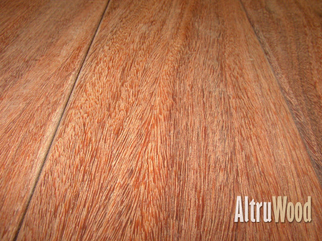

So did you take any pics of them fully completed with the spikes? I'm curious how they look from the top and how you fastened the spikes to the bases? Also, where did you get the rubber pads you put on the top plate? I used to have tons of them that came with all my speakers from AV123 but I'm all out now and need more for the tops of my stands :)
For an update, I picked up a 12' x 5-1/4" x 1" piece of Cumaru (Brazilian Teak) yesterday at this great place called Crosscut Hardwoods in downtown Seattle. Normally this stuff is very pricey $10+ per board foot and I got the whole piece for $14.75 :D Woo hoo! We got the pieces cut down to 4-1/8" wide each x 4' and glued them all together. Right now they're sitting all clamped together getting all nice and hard. Tomorrow we're going to plane them down so they're all perfectly flat. This wood is INCREDIBLY heavy and dense. Its actually one of the hardest woods on the planet.
I'm going to be making the bases 12"x12" and the tops 8"x8" and use 3" PVC for the tubing. These things are going to be VERY heavy! I'm guessing at least 25 lbs each but we'll see once we're all done.
I'll take pics tomorrow when we get it planed down and cut to size. Here's a closeup pic I pulled from the web that shows the grain pattern for this wood, its VERY unique!!

Found out just how hard this stuff is, check out these ratings: http://workshoppages.com/WS/Misc/Wood-Hardness-Chart.pdf
