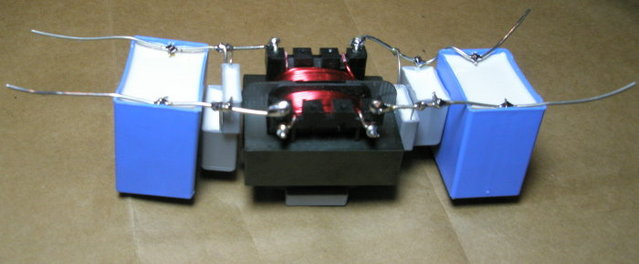

I purchased all my capacitors with 1-1/2" legs and will be going boardless.  I plan to get started next weekend after the holidays wind down.
Martin

GBB's build. Mmmmmmmmm.... dead bugs (as in 'dead bug' construction) Put some shrink tubing over it, shrink, and you're done.
If one cannot build that, or on a perf board, they've absolutely no business dealing with lethal mains voltages.
I was looking for that pic as illustration but could not find it.  That's how I plan to build mine.

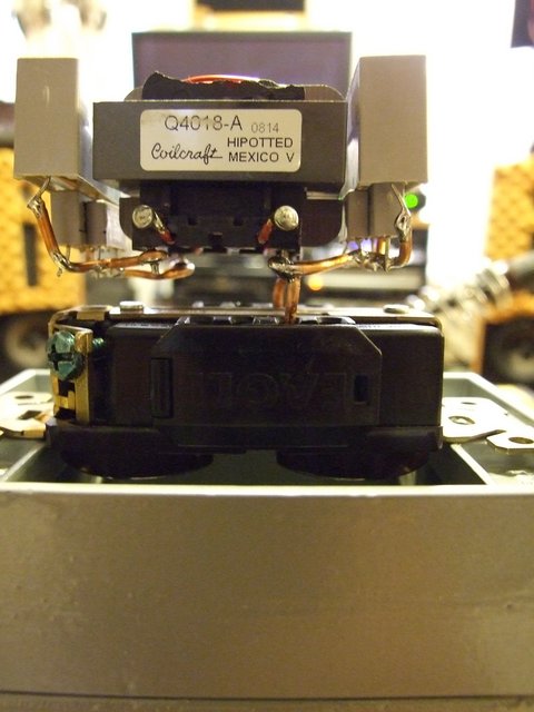

For a stiffer rail one can use 12 Ga. solid core house wire...this one was made for direct mounting onto an outlet.
piggyback the caps for compactness...
Fuse as appropriate, for safety.  :thumb:
