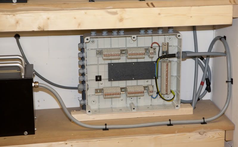

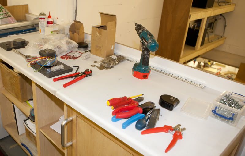

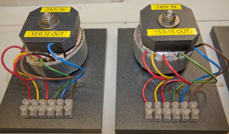

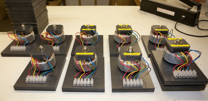

A few pictures of the progress this week.
Made a 1 in - 14 out (2x7 a side) connector box for the transformers and fitted it into the transformer box on the outside wall of my office. It already houses a 2Kv balanced for the Cd player and a 3Kv balanced for the Pre.  As I said before the incoming will be fed from a 5Kv isolating transformer.
I have left a plate in the box ready to mount two soft start modules. This will allow for the seven a side configuration and also allow for all the transformers to be powered at once.
Mounted some of the transformers onto their boards and set the wiring up to them.
Nearly ready to go into their permanent new homes.
serengetiplains
Re: Buffalo Dac build
« Reply #38 on: 22 Jan 2012, 08:41 pm »
Fantastic, Steve.  Are the blue/brown wires shielding screens in the transformers?  And how did you drill the marble (pseudo-marble?)?
NicMac
« Reply #39 on: 22 Jan 2012, 09:27 pm »
Absolutely top notch!
I think the green/yellow wire is the screen connection and the blue and brown 240VAC.
They look like audiophile Canterbury windings TX's.
Can't wait to see more pictures of this build.....
