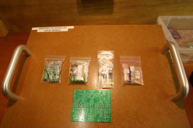

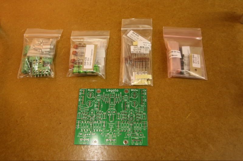

A couple of pics just for starters of the kit & how it arrives (Legato) and my first basic layout board. The idea for me is to build the two full kits as completely stock, then start the two bare PCB's as the best I possibly can with no holds barred components where I can.
As outlined by Paul above this is probably going to be a fairly monumental build for me, especially as I have not done anything like this for a while.
I promise the pics will get better, my garage was freezing and I need to get some brighter lights so I can get the lens to work properly.

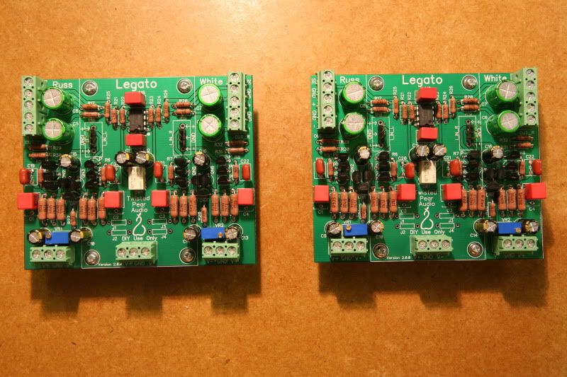

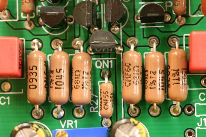

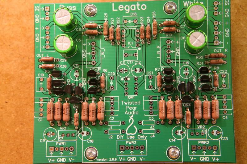

Well it's been 35 yrs since I wielded a soldering iron to do work like this - so this board is going to teach me a fair bit. Some close up photos show that a little more solder was needed in some cases - but that can soon be put right. A bit of flux cleaning may be in order as well I guess. Close inspection showed no dry joints or crossed traces - so I'm happy for now.
A couple of hours this afternoon saw all of the resistors in place and a couple of caps.
Tomorrow , if I can grab an hour or so will see me attempting the first multipin opamp ever, they look a bit close together do those legs. I need the eyes I had thirty years ago..
This shows where this board will sit, the next will be to the right. Hopefully the clear l/h side and front will be enough for a couple of psu's.

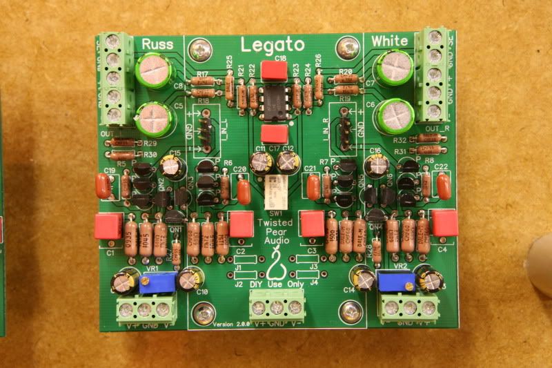

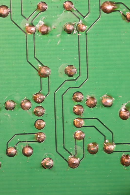

Those op-amp legs are just a bit small, but a small bit in the iron and my strongest glasses - all went to plan, I think.
Time allowed me to not only complete the first board but alos the second as well. Mind you, a bit of practice soon gets speed up.
Next is to put a couple of connectors on a back panel for signals in & out.

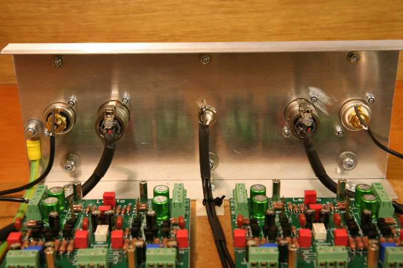

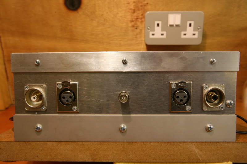

I managed to spend a couple of hours over the weekend knocking up a basic back panel for input / output. A pair each of RCA's & XLR's for output (I usually run fully balanced) and a 75 ohm BNC for spdif input duty.
Even trying very hard I managed to reverse one set of xlr wires, but spotted that when staring at them through the camera lens...
I have the basic list of PSU's to get this running, and the dac boards are due for despatch now.

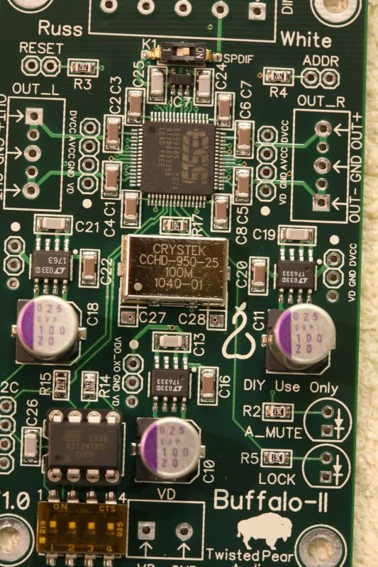

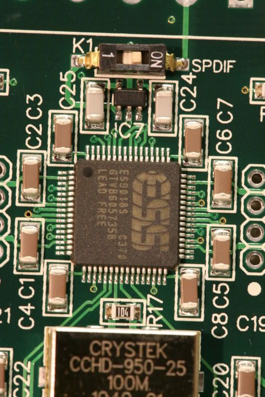

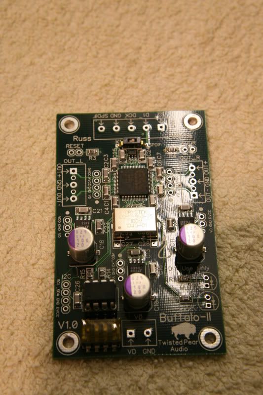

As promised some pics of what you actually get with the Buffalo II dac.
They arrive very well packaged in a folding strong cardboard box – wrapped in anti static bags.
The main dac board, AVCC module and mounting hardware.
The AVCC module.
Main DAC board
The object of most of the forthcoming hard work:-
That dac chip is just on 9.5mm square - I would hate to try re soldering that thing.

I wrecked my first Buffalo (32S, predecessor of the BII), and did unsolder the DAC chip and fit a replacement- successfully! Bloody tricky though. No specialist gear- just a fine tipped soldering iron, fine solder, and a jeweller's eye glass fixed to some reading glasses by a rubber band!
Best wishes
