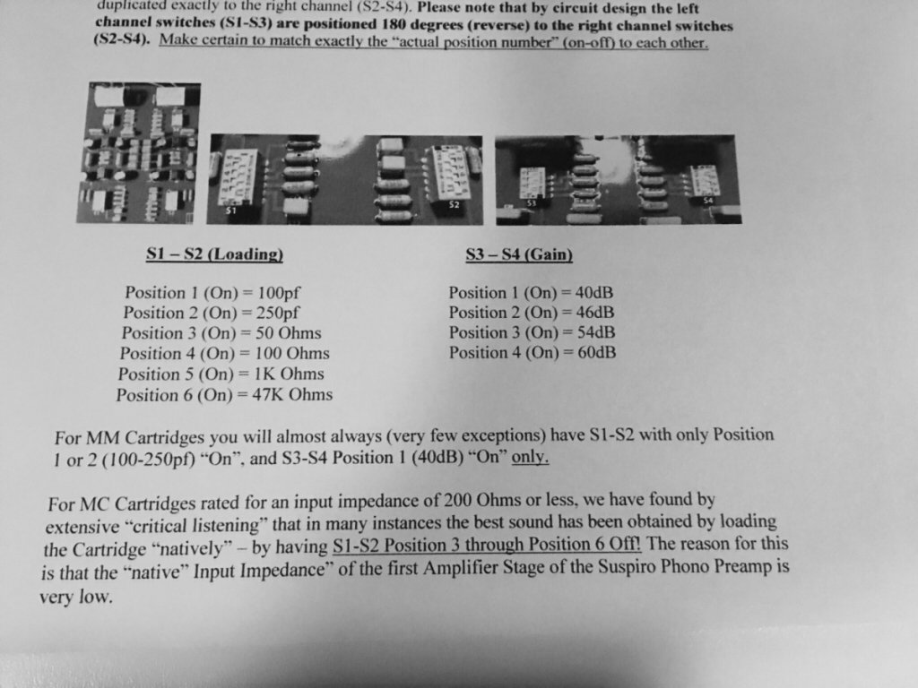

I'm assuming 65K is a combination of 47K and the 250pF. Below are the instructions for my phono stage. Please correct me if I am wrong.

No.  You have 2 different parameters here.  One is impedance/resistance and the other is capacitance.  47K is the only MM resistance option here.  In order to get 62K you would have to remove a set of resistors and replace them with 62K.  It looks as if you could do that, or have a tech install them.  If there is a resistance value you don't use, like maybe 1K, you could replace those with the 62K.  You could also replace them with 100K and use loading plugs to get any resistance you want.  Use a parallel resistance calculator to figure out net resistance.
The other is capacitance - that's the total value of preamp + cables + internal arm wire = capacitance load.  In this case (M97) you want to maintain at least 250pF, but not much more.  Depending, your wire/cables might be 125 - 150pF.  Combine that with 100pF on your preamp and you should be close.  Only thing is you cable capacitance is unknown.
The way it is suggests an SAS is the way to go.  It probably is anyway.  The M97 is said to be one of the most successful SAS couplings.  I think you should get the RCM first and get that out of the way.
I know this stuff is confusing and I didn't explain much.  If you have questions don't hesitate to ask.  If you don't understand parallel resistance and capacitance, all this must seem like voodoo.
The capacitance of my RCA cable to the amplifier is roughly 21 picofarads per 2 ft, which since I have 3ft makes 31.5pF. Does the output to the amplifier even count? I wouldn't think so. The Audioquest tonearm is connected by an unknown SME tonearm cable that connects to the phono stage in. Any idea of how to identify it, or is that not really necessary?
The cable to the amp has nothing to do with this, but it's more likely 21pF/ft.  The capacitance the cart sees is the arm wire + arm cable + preamp.
Can't say for sure but an SME V cable, which is a VdH 501 is 155pF.  If yours is like that one (silver wire) then you should be fine with the 100pF switch.
It's also hard to estimate the arm internal wire.  KAB says the 1200 internal wire is only 10pF.  But this could go as high as 50, so between 10 and 50pF.  :scratch:
You're still probably fine with 100pF.  You can determine what's best by listening.   If the capacitance is too low it will sound distant, rolled off - depressed in the treble region and loss of extreme high end.  If capacitance is too high it will sound too bright upper mids to treble, with even less extension.
