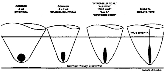

I have a Z-1 stylus (original), which is also a Beryllium cantilever with a nude square shank Shibata tip. It looks and I assume it 'is' the same cantilever/stylus as what is/was found on the X-1. To my ears, these two cartridges (the X-1 and the Z-1) when fitted with their original stylus assemblies, are identical sounding. The plastic part of the body has been changed on the Z-1 and also the body of the X-1 which was gold plated is now just bare metal on the Z-1. A few of the published specs. are slightly lower on the Z-1 but even they are well within allowable tolerances of the X-1. Neither of the mentioned changes would effect performance but they both would reduce cost to manufacture. Perhaps due to mass production, is the reason for the much lower pricing of the Z-1? I think there has to be some other explanation why JVC chose to change the stylus holders. Perhaps they too were cheaper to produce in the 'Z' configuration? But I do agree that they must be the same generator.Regards,
