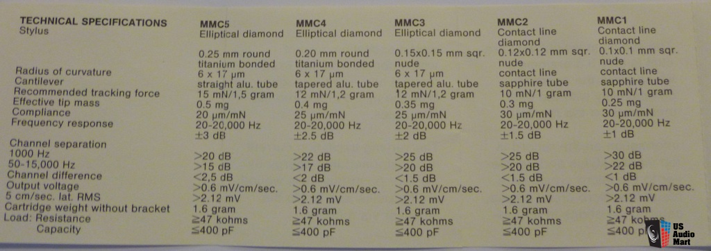

I saw this ad on US Audio Mart for a NOS MMC2:
http://www.usaudiomart.com/details/649141968-new-in-box-bang-amp-olufsen-mmc-2-pickup/
Nice little chart in the ad:
The MMC 6000 has a beryllium cantilever and a tip they called Pramanik - probably like a shibata.   VTF = 1g, cu = 30.

And the TK7LCa, well it is basically an AT20ss isn't it - and I have to say the AT20ss is pretty spectacular... :thumb:
I agree, the 20SS is a great cart, but it doesn't have colorations some prefer.  There are so many ATs over the years it's hard to keep the numbers straight.  The 20SS is 2.7mV, 500 ohms - response to 50K.  The 7LCa is 5mV, 800 ohms DC, 550mH - response to 35K.
The 7LCa is slightly sweeter, more seductive, while retaining good resolution.  IMO the 20SS gets its sweetness from the shibata and is a little more neutral, transparent, and slightly more resolving.  Both great carts.
neo
