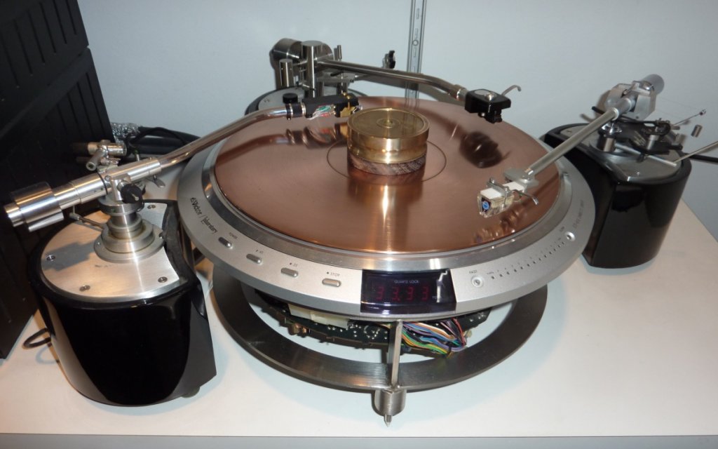

Hi Neobop,
Victor TT-101 actually....
Fully nuded in custom stainless steel cradle with 25lb custom cast bronze arm-pods.... 8)
AT33Mono is less than $400 and is loaded at 220 Ohms. Ortofon Cadenza Mono is over $1,000 but should be even better... :P
Lets take another gander at that table.  As Jackie Gleason said, How sweet it is!!
Is that a delrin mat?  The arm in the back looks like a FR64S?  the one on the left a DL 308 maybe?  What's the straight one on the right?
You have lots of people drooling around here.   :drool:  Thanks for the cart info.

Halcro
  • Posts: 140
Re: Clearaudio MM -- AT-95E and beyond
« Reply #843 on: 12 Nov 2014, 11:24 pm »
Thanks for the compliments guys.... :D
That's actually a white record on that first image Neobop.... :singing:
On this image....that's
 the Micro Seiki Cu-180 copper mat...
You're right Neo....that's a FR-64s arm at the back...
whilst it's a Micro Seiki MA-505s arm on the left  8)
The straight 12" arm on the right is the SAEC WE-8000/ST
One of my favourite all-time arms... :rotflmao:
