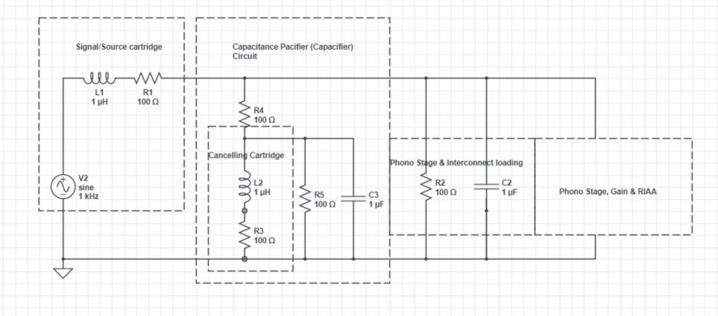

I experimented with this concept a couple of years back before deciding that instead of trying to turn an MM into a MC, I should experiment with the EQ possibilities and their impacts (both phase and amplitude)....
Here is the Capacifier circuit:
This really is a "rif" on the same principle - set the capacifier R and C values to the same as Scotty's and you have Scotty's mod (some of them would be set to null value)
To go with this diagram I also have a spreadsheet that models the electrical behaviour - it can also be further tweaked by measuring the actual behaviour of a cartridge, cancelling the theoretical electrical behaviour from the measured to provide a "raw mechanical" (+ non linearities) baseline, that can then be used to model what will happen with various parameters.
These circuits do as advertised - you can (with the right values on the components) effectively get the same results you would have were your capacitance far lower - so it is a means to attach Audio Technica cartridges that work best at low C loading, to standard phono stages with loadings of 220pf (+interconnect of 100pf or more...)
This is very flexible - if you use a p-mount adapter in the circuit setup, you can quickly and easily switch cancelling cartridge bodies to experiment further with tweaking the voicing.
There is a long thread on this topic here:
http://www.vinylengine.com/turntable_forum/viewtopic.php?f=19&t=33929
bye for now
David
P.S. please ignore component values on this diagram... I just threw it together to show the outline... values would obviously vary wildly based on what you are using it for and with which cartridges.... the two cartridges involved need not match. - For best results, as in all things audio, the two channels should be matched as closely as possible.... this is the trickiest part given variation in cartridge inductance between channels on many exemplars!

You mentioned the Capacifier before, but I didn't check it out.  This is very similar to Scotty's circuit except no series resistor after the cart, but there is one on the dummy (R4), and an additional one R5 and a cap in parallel to the dummy but not R4.  I believe there's a downloadable calculator?
This is a 35 page thread on VE. It's designed to null input capacitance?  Could you cut to the chase and tell us what happens to inductance?  It seems to me without inductance the net amplitude response will be defined by mechanical performance.  In many cases without the inductance in the original design amplitude response could be less than ideal.
I plan on reading the thread, but that's what I said before.  If someone can load their MM with specified capacitance is there any benefit from this Capacifier?
neo
dlaloum
  • Posts: 710
Re: Clearaudio MM -- AT-95E and beyond
« Reply #792 on: 30 Sep 2014, 12:27 am »
If you can load your cartridge with any desired capacitance from (say) 50pf up, as well as opt for a reduced inductance (which may not be needed if the C is low enough) then the circuit is redundant.
The whole idea was to overcome the limitations imposed by most phono stages which start out with too high a capacitance.
The additional bits of the circuit allow tweaking/adjustment of the electrical resonance, and the rolloff slope and turnover frequency...
So it not only allows one to "expose" mechanical behaviour but also to  voice the system by choosing how much compensation / EQ to put into the system.
Ultimately I found it easier and simpler to use traditional loading combined with a fully flexible low Capacitance and high resistance phono stage (ie: I can set up for R from 500k down and C from 50pf up)
It really is just a fancier version of Scotty's circuit - courtesy of LuckyDog who developed it - I did a lot of testing of it, and  helped convince him to also publish the associated calculator.
If you take that calculator and "mess" with it, it can be a very useful tool in modeling cartridge behaviour, and as I mentioned, with additional work you can also incorporate the mechanical behaviour allowing you to more accurately predict what a cartridge optimum load might be.... (it hugely speeds up optimising a cartridge!)
bye for now
David
Sorry, I didn't read the thread.   "the two cartridges involved need not match"  Do you mean just channel to channel?  Those are two of the same cart?
Do you change the values of R5 and C3 to tweak?  What about R4 ?
How is overall inductance affected?  I don't think either Scotty's or this circuit nulls inductance.  Looks to me as if inductance is diminished so electrical resonance can be manipulated.
neo
