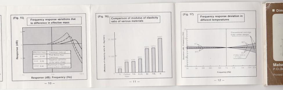

Check out this photo of a EPC-305MC boron tube cantilever.  It's the last photo in the row:

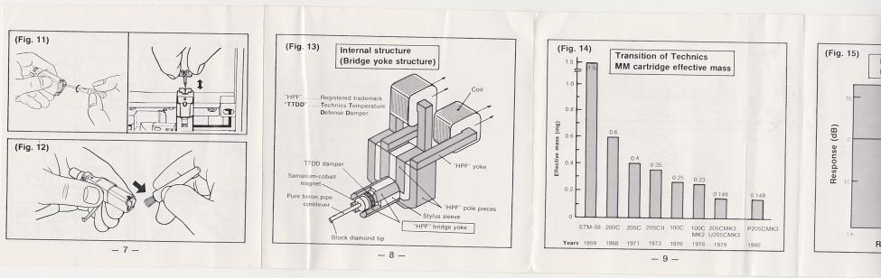

That photo of the Technics boron tube cantilever is germane to the discussion on Agon MM/MI thread about exotic tube cantilevers.
Here's some information about the Denon DL-1000A and its cantilever:  (activate translator function)
http://www.denon.jp/jp/museum/products/dl1000a.html
According to J. Carr this is probably the lightest moving assembly ever made - 0.077mg.  The criticism is the diamond mounting technique is not rigid enough.   The bottom wall of the cantilever is removed for tip mounting.   Also, output is 0.1mV, so it was difficult to amplify.
It seems obvious from the above photo that Technics kept the cantilever intact, or possibly only drilled through the bottom to mount the tip.  The Monster boron tube cantilevers looks different from both of these.  It flattens out at the end and angles to be more parallel to the record surface like many aluminum cantilevers and the flat mounting surface appears to be the thickness of 2 tube walls.   Of course I never measured it, but this was obviously by  design
This whole discussion of tube cantilevers makes me wonder about priorities.  I never heard a DL-1000A, but I wonder if detail is compromised by the tip mounting.  J. Carr said that if anyone knew of boron tube availability to please let him know.  This technology was available 30 yrs. ago, but can't be reproduced today?

As tip mass increases, resonant frequency decreases while amplitude of peak increases.  That's why a boron/ML tames a 440.  A beryllium/ML tames it a little better IMO.  Beryllium is lighter and a little more flexible, so it's slightly warmer or less exacting, also with less tip mass.
