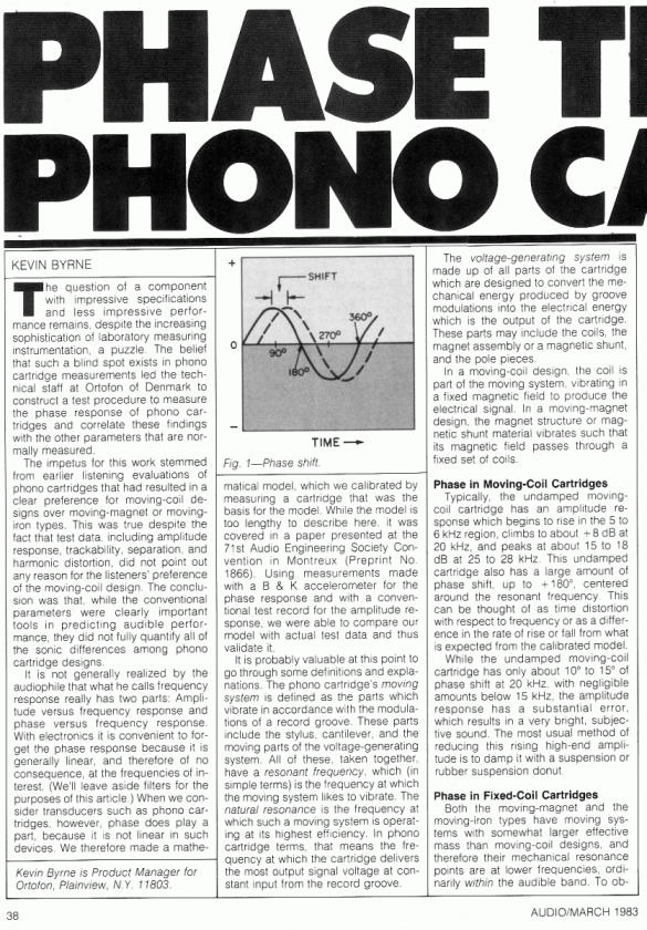

Do you still have the Ortofon paper?  If so maybe you should reread it when you get a chance.  It could be that a secondary cantilever resonance causes a phase anomaly, but if I remember correctly none showed up on the MM tests.  Those were 5 unnamed MMs from 1982 or thereabouts.  Surely some had aluminum cantilevers.
The MC, an MC200 (I believe) had spectacular imaging when left undamped, but the naturally rising high end, 10 dB @ 20KHz, rendered it unlistenable.  Damping the cantilever compromised the imaging, but for listenability they took it down to about a 2 dB rise at 20KHz.  It then had phase non-linearity down to just below 10KHz.  The rising high end wasn't to please audiophiles, it was a compromise to preserve imaging/phase as much as possible.  High frequency res was 27KHz and there were no phase problems within the audio band when undamped.
The contention was that all carts have a naturally rising high end and damping is required not just to tame the high end, but also to control the cantilever.
To be honest it's been a long time since I read it.  I'll have to dig it out and read it again.

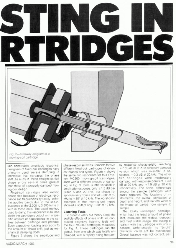

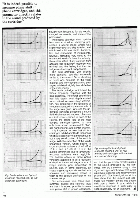

The Ortofon Ortophase article was a series of tests done using several MC200's with the cantilevers variably damped...
And they demonstrated that phase anomalies occurred wherever there was a resonance!

I had to download the article again.  I lost it when the last PC died.  My email was malfunctioning, what a PIA.  Anyway:
Although it didn't show up on the graphs, it seems you're right about secondary resonances and electrical resonance causing or contributing to phase shift.
Because there were no obvious glitches in MM phase vs amplitude response, I think electrical resonance' contribution to phase anomaly is additive.  That could be the case for secondary resonances as well, otherwise there should be a spike.  Perhaps the resolution of the graphs wasn't sufficient to draw that conclusion, but I think it was good enough to see an obvious secondary anomaly.  What's your take on this?
The case of the MC200 is almost exactly as I described.  180o shift at HF resonance (all carts including MM).  Undamped amplitude + 7 dB @ 20K.  The other samples +3.8, +1.9, and -0.3 dB respectively.  Conclusions were just like I said, based on phase integrity not amplitude response.

What I find interesting in the article, is that they state the outline of the facts (phase and amplitude), state the outcome of the golden ear listening tests.... then state their conclusions.
I read the same facts and the same listening tests, and I am not convinced by the conclusion.
The most heavily damped MC200 in that test, has its frequency-amplitude deviation in the high midrange (10kHz) zone - where it would be most obvious!
The undamped example has no phase variation to speak of until up around 25kHz - so what the golden ears are hearing is all amplitude variation...
Was the improved soundstage due to phase correctness in this sample - or was it due to exagerating the amplitude of those frequencies that most influence imaging/staging?
The only way to tell would have been to EQ the undamped sample back to flat using linear phase methods - something which would have been technically almost impossible at the time.
The influence of damping, EQ and resonance are all minimum phase, they are all additive - and they are all symmetrical with regards to amplitude - which means if you correct the amplitude using a minimum phase method you will as a side effect also correct phase....
At least this is my impression from reading as much as I could find on the maths behind these phenomena..... it is also coincidentally very convenient!
In the third cart tested - the damping has controlled the resonance sufficiently to expose the slight midrange trough that one would expect from standard cantilever behaviour.
The last one - with the heavy damping - seems to have something else going on altogether. Not only is the resonance damped, but there is a also a boosting effect around 10Khz which also fills out the midrange trough (and ups its amplitude a bit too much) - hard to tell what is going on - and there is insufficient information provided for more analysis - my suspicion is that the damping method has introduced additional resonances lower down that are boosting the amplitude - although the lack of phase change seems to indicate that this is not the case..... something suspect about the 4th example.

So you think amplitude was responsible for the great imaging?  I don't, although like you say we can't be 100% sure.  Maybe it was a combination of the two, but I think phase is mostly the reason.  Does an overly bright record or cartridge image better?
Moving mass - wasn't the EPC 100/205 the exception rather than the rule?  In the '80s it was generally thought that MCs were usually faster.  Do you think Ortofon was being deceptive?  They must have been aware of Shure, AT, Stanton etc.  I wonder what those 5 MM were.
Well, I think it's obvious there's no 180o phase shift at electrical resonance, as stated by that inmate at the asylum.  Without the use of minimum phase filters, phase integrity is important IMO.   I suspect that any additional filters, EQ, will degrade the sound, provided you have top flight source components.
